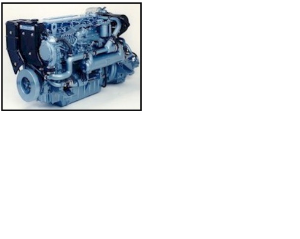

    Considering a boat with the Perkins-Sabre M300Ti motor from 2003.
    It was an option on the boat, at the time, the Albin 28TE, but not very popular: Looks like
    Most owners went for the 315 hp Yanmar.
    (The Perkins is 300 hp in this application)
    Talked to one of the Perkins dealers in town and he said there is no parts for this engine in the US, everything had to come for the UK.
    Sounded strange and perhaps I talked to the wrong guy.[​IMG]
    Does anybody have experience with this engine? The good, the bad, the ugly...?
    http://www.tadiesels.com/releases/P-Sabre_M300Ti.pdf

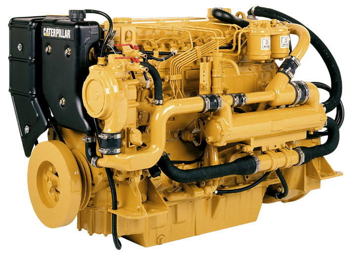

    Its got the same bore and stroke as a CAT 3056 at 3.94" x 5.0"
    The last one of these 3056's I worked on which was an emergency genset had the Perkins logo cast into the Cylinder head.
    I would hazard a guess that they have a lot of similarities.
    Dag, If you need parts from the UK, I can help you or put you in touch with someone who can.
    This is a Perkins Sabre off the link you posted. They look quite similar.
  6. K1W1
    7,392
    Those Fuel Filters on the CAT are the identical twins to the old CAV 7111-296 Elements that Perkins have used since the year dot.

    There are some CAT engines that Perkins then branded as theirs. I don't know if this is one or not. Regardless, I suspect many interchangeable parts based on what K1W1 has shown.

    Ha, them engines on the pics look like twins:)
    Now back from Diesel Services of America: Talked to the guy the Parst counter and he indeed said most if not all parts have to come from the UK, even stuff I thought would be generic like injectors and heat exchangers, oh well.
    Good news on the CAT Twin however, I will find a CAT dealer nearby and chat with them about interchangeable parts.
    Thanks again, this forum is invaluable: I had no idea about CAT and Sabre being in bed together.:)

    This is the motor...
    [​IMG]
