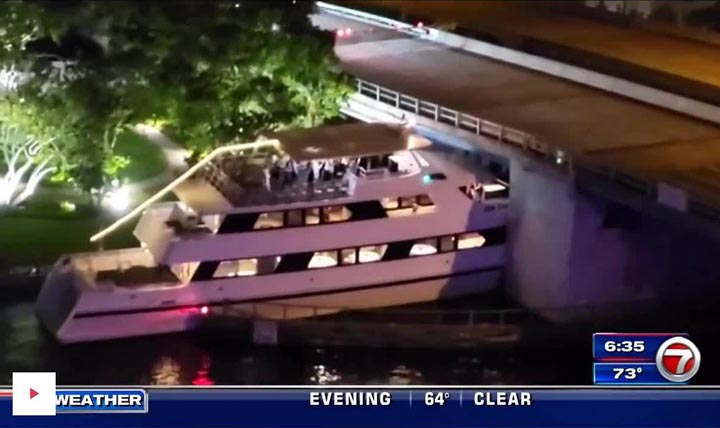

    If the boat was northbound on the ICW, it would be nearly impossible to get into this predicament at the Sunrise bridge. The Hilton Hotel docks are located directly behind the stern. I'm merely speculating, but is it possible they were disembarking and someone bumped forward gear?
    Photo credit: WPTV

    14,432
    The boats permanent slip is about 50' behind where it is sitting. Looks like it just drifted into the bridge.

    12,647
    The reporter describes the yacht slammed into the bridge. Looked like an easy drift.
    I can see a little stb aft clutch action just before the video ends.

    I don't know the area or the currents, but it looks to me like it must be a really strong current to have drifted that hard in to the bridge. I think Carl may be correct with his theory of someone accidentally putting it into gear. My humble thoughts only.
