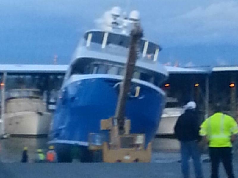

    It seems that they have building boats that require ballast to stay upright in that area of the United States for years. My Dad went and looked at a 58' Delta limit seiner for a relative in the late 70's and he thought it was a bad design. I won't repeat what he actually said about it.
    When that boat was shown a couple of days ago I tried to find a video of one of there boats but couldn't find it. It looked like it was going to lay over just from crossing it's own bow wake. It's really sad to see. U.S. yacht builders don't need any more problems. Thankfully no one lost their life.

    The owners may well be in shock and mourning now, but they should really be counting their blessings that this happened at the vessels launch.
    Imagine cruising to places an 85' ocean going passage maker should be sailing and overnight a small storm occurs and we are all left wondering what happened to the ship and it's crew.
    Let's say they had "fiddled" the ballast to get past the shakedown (no pun intended) and the owners had felt comfortable and excited to load themselves, their family and crew for a long voyage!
    In this day and age I cannot understand how this could happen in a first world country.
    I would be checking my build contract with Northern Marine if I had one, and cancelling ASAP.

    Nobody knows what really happened. It could be that the boat is fine and the travel lift/railway lift gave out and rolled the boat on it's side....much like it did with Sacajaweja back in the day (but rolled it foward on it's bow) .in the picture of the starboard side near the rear, it looks like there is a big area that was pushed in (in the bottom paint)

    Spending $10million on a new build with a design brief that included:
    " breaking new ground in every step, this project would redefine innovation, ingenuity and design in the yachting industry."
    Why no tank testing?
    I am asking, not accusing. Is a tank test so expensive or worthless?
    As this build was breaking new ground, I would have thought the testing would be done before the money was thrown in the fire.

    Police Capt. Lou D’Amelio told the newspaper that the boat began to roll onto its side in shallow water as it was being launched. As it began to roll, several people went into the engine room to adjust ballast. The yacht continued to roll, and the engine room began to flood. Most of the workers on board were easily rescued, but one man was trapped inside.
    This seems to be a slightly additional twist that the workers who were on it were trying to adjust the ballast. I'm not very familiar with the use of ballast but didn't perceive of it being something that you could just go below and start quickly moving around. Someone more knowledgeable can educate me on this please. But could it have shifted like the cargo on the Korean ferry?

    I read another report from a "mechanic" who was onboard that the starboard stabilizer seems to have hit some rocks during the launch and that they were trying to "thrust down" when the roll started.
    You would hope Northern knew, or checked, the lamp for clearance and that if they did get stuck they didn't just put the yacht in reverse to get it in the water.
    They YouTube Channel "YachtVid" shot the owner's last boat for sale (a Marlow 61') and had a video of them moving "Baden" out of the shed. They also did a video of Northern's most recent fishing boat launch, so I would think they have a video of this (failed) launch.

    Some of those designs use fuel or water in tanks to adjust ballast. I doesn't happen quick enough unless she laid on her side for a while. It sounds like it took a little time to roll. If those port holes at the waterline were compromised it wouldn't take long to sink.

    There are three images at the Seattlepi website. The second image looks like there is damage to the hull. Any thoughts?
