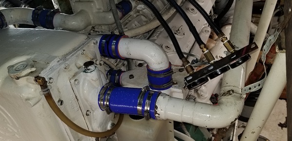

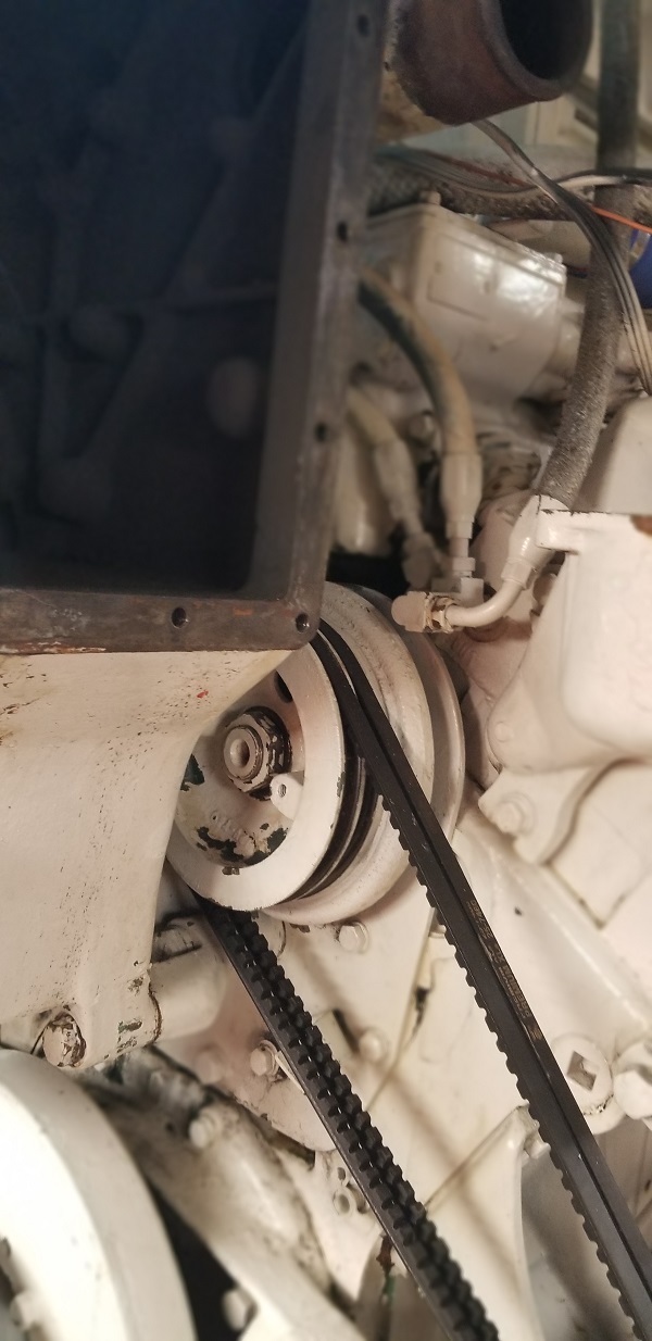

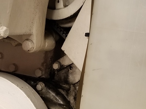

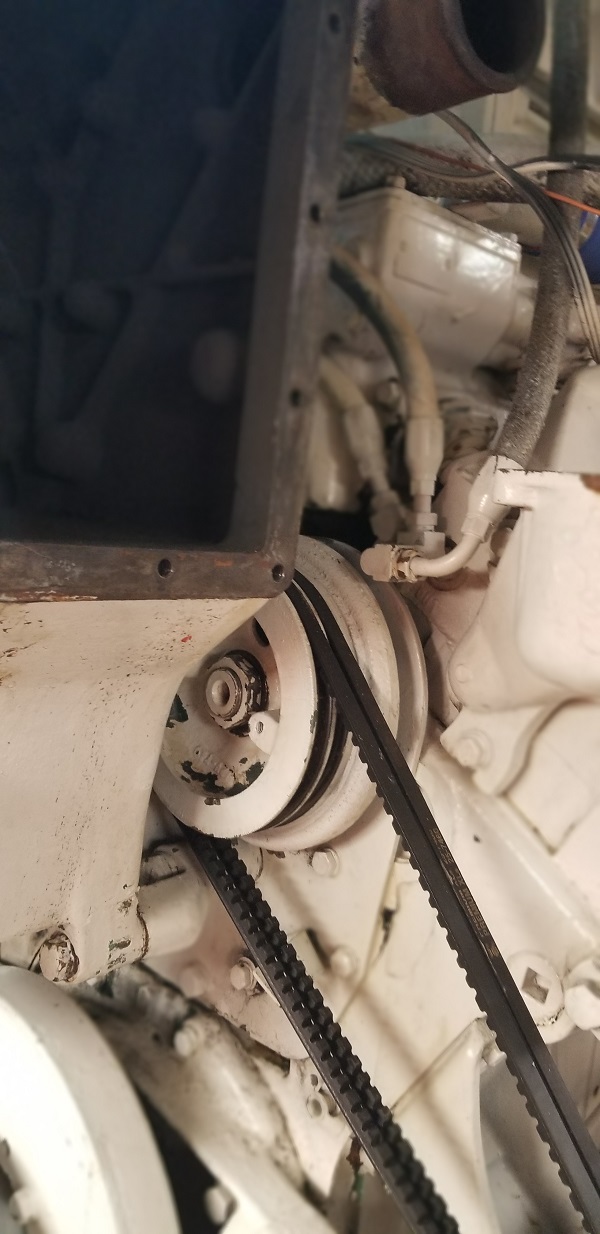

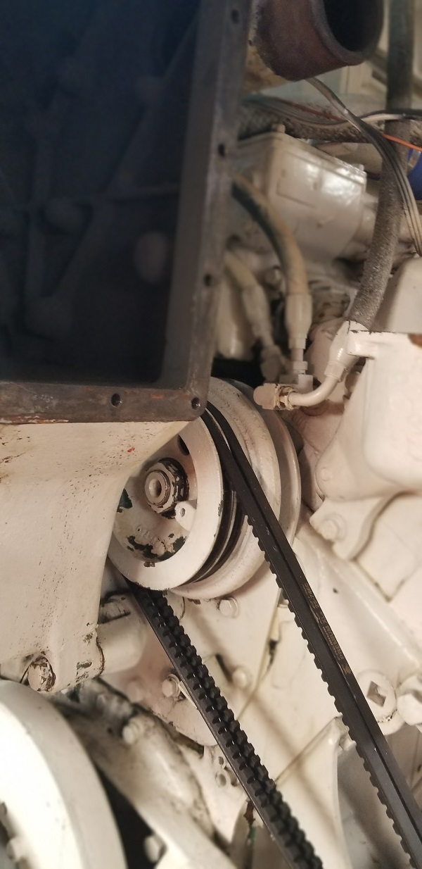

    16 years ago, I replaced the PTO seal on my stb, 12V71.
    14 Years ago it started leaking,, again.
    Been putting it off till it finally started pouring oil out.
    F M

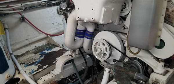

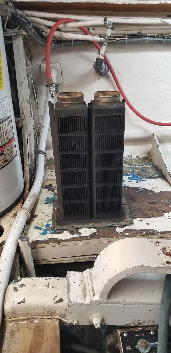

  2. Capt Ralph
    12,713

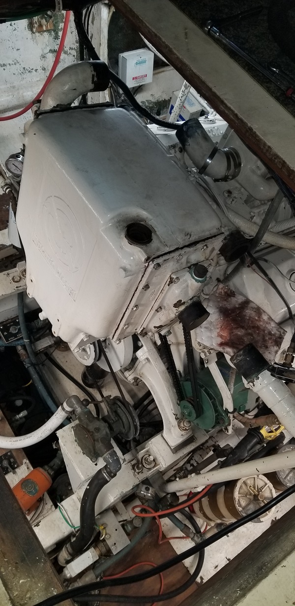

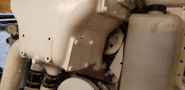

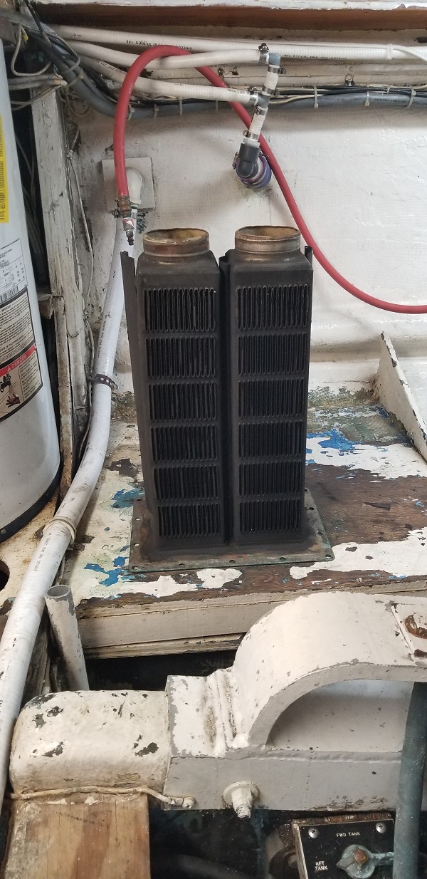

    So, Big asp heat exchanger gets hoisted from over head. New seal AND cam shaft race get replaced.

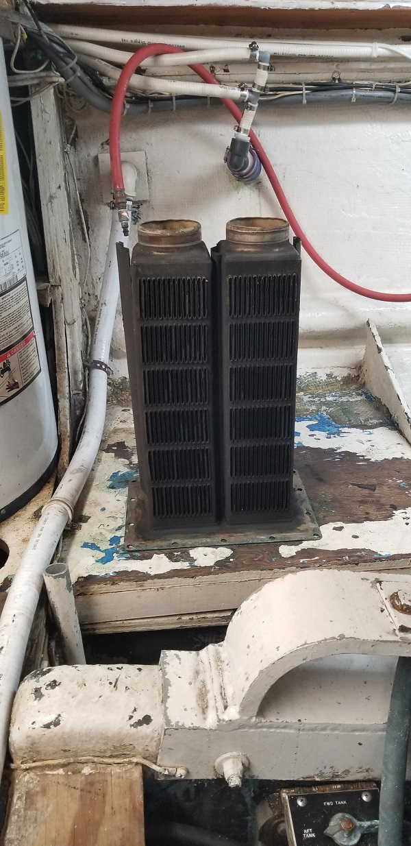

    So, while the hoses and plumbing are in my hands, lets pop the core, re-seal the weeping H/E gaskets and clean her up.
    All looks good here.

  3. Capt Ralph
    12,713

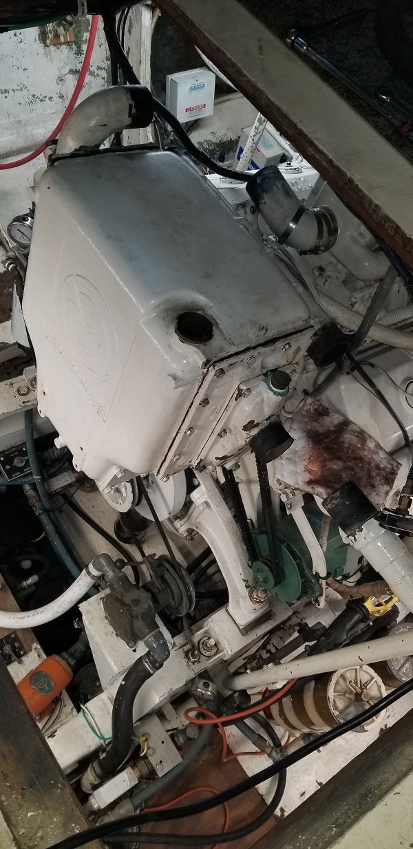

    Then, those new hose clamps I installed a few months ago look sad against those old ugly rubber hoses. If It's all apart, lets clean up those ugly rubber hoses.
    Another quick call to my DD shop, another credit card wiped out, new blue silicone hoses on their way.

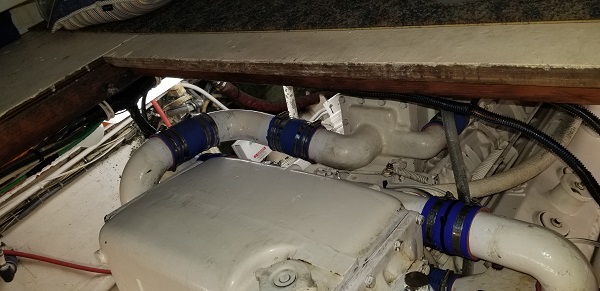

  4. Capt Ralph
    12,713

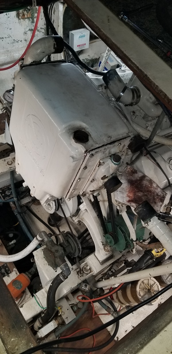

    New Hoses installed last night and today.
    All purged (dock side).
    Hopefully tomorrow can leave the dock and get the girls warmed up.

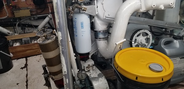

  5. Capt Ralph
    12,713
    Oh, poor lil sweet port engine, that's NEVER been an issue, is feeling lonely.
    Ha, ordered extra gaskets and hose, she will be extra pretty soon also.
  6. Capt Ralph
    12,713
    BTW, That one hose (pic post #5) is 3 7/8" ID.
    Find that in blue silicone. It is available, just be prepared to B O A T*.
    * Bend Over And Take-it
    A great phrase our bud explained to us.
    My credit cards and I have been using this phrase quite often since.
