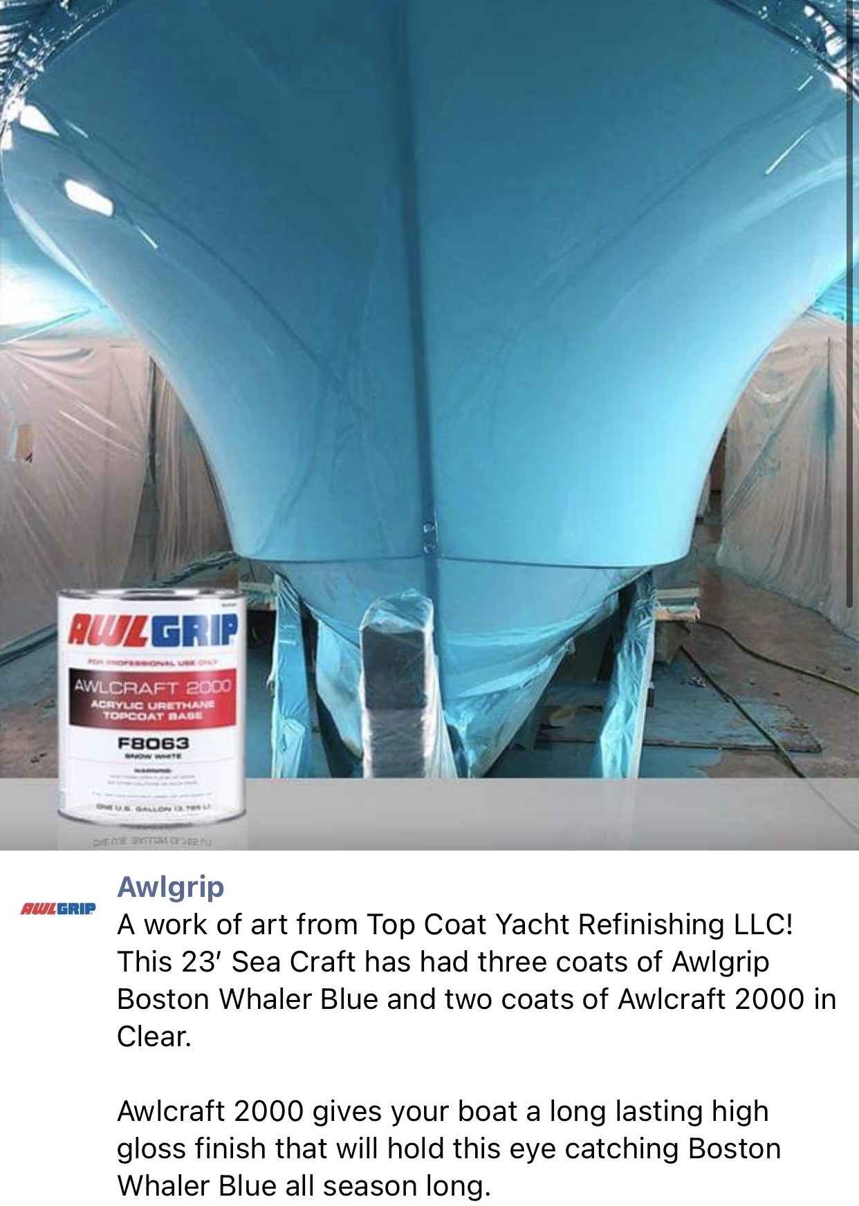

    Well the time has come to paint our 50 Post. The hull is overall in good shape but is starting to show its age and the gelcoat is dulling. I compounded and waxed the boat last year but it really needed a good wet sand. Based on the cost of wet sanding every few years and the ease of maintaining a painted hull, we decided to get on a schedule for this winter.
    We spent a lot of time looking at paints as our friends have a 48 Ocean painted in AwlCraft “Light Blue” which is beautiful. We decided we wanted a touch more color and are plannin going to with AwlCraft 2000 “Whaler Blue” with several coats of clear on top done at New England Boatworks. We were also planning on painting the boot stripe so it will be more resistant to wear over it’s life.
    Anyone have any thoughts on painting versus not painting the boot stripe? For the boot stripe, it would likely be a dark blue (flag blue) or black.
    The sanding should be started later this week, donut is like Christmas all over again!

  2. Soulstice
    Soulstice Member
    Apr 1, 2013
    149
    Portsmouth, Ri
    Whaler Blue

  3. Capt J
    14,434
    I’d paint the boot stripe.
    Soulstice likes this.
  4. Soulstice
    Soulstice Member
    Apr 1, 2013
    149
    Portsmouth, Ri
    Thank You, that was my feeling too but I wanted to make sure I wasn’t overlooking potential issues.
  5. d_meister
    d_meister Senior Member
    Mar 4, 2010
    469
    La Conner, WA.
    Boot stripe tape? Renewable, repairable, and removable.

  7. C team
    C team Senior Member
    Nov 1, 2011
    244
    Kent Island
    I would also paint the boot stripe! Since you're investing a hefty paint bill, why wouldn't you have the boot painted too?

  11. Mark Cardillo
    Mark Cardillo New Member
    Jan 7, 2019
    5
    Gloucester
    I have a 1996 50’ Post that was painted light grey with a royal Blue boot stripe back in 2013 with Awlcraft 2000. I am very happy with it. I have the entire boat waxed once a year and it has stood up well. I use the boat 12 months a year. I am in Gloucester Ma from June till End of October and Stuart Fl from mid November till end of May
