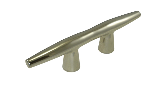

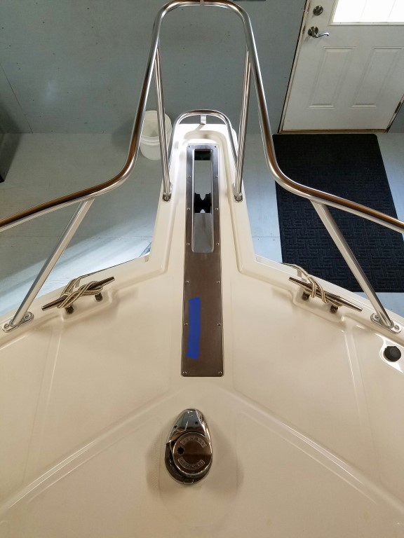

    As I go through the 40 Cabo I recently purchased I am upgrading a number of systems including the ground tackle set up. I recently purchased a 35lb Delta Anchor along with 64ft of 3/8 chain and 300 ft of 8 plait rode. On my last boat I added a Buck Algonquin cleat forward of the windlass that I would tie off to when anchoring. On the Cabo I am staying with the existing Lewmar V2 windlass and I am trying to determine if I could add a Buck Algonquin cleat in front of windlass just off center line or if I should make a "Bridle" and use that going off current bow cleats. Obviously adding a cleat in front of windlass would make securing the anchor a quicker process but not sure if there is any downside of having the load travel through the pulpit vs the current bow cleats on each side?
    Any Thoughts?
    Thanks
    ** Edit: Determined that a cleat would layout better than mooring bit on pulpit. I would mount a little further to the port than blue line I added to photo. I would use stud style cleat to allow for clean install on furthest Port side of rub strip.

    I agree with Pascal and don't see the need for a bridle. I anchor in much deeper water regularly and I just make the 8 plait line off to my C/L cleat that is behind the windlass. To each his own but a bridle just seems more work than necessary. As long as you are made off to a good strong cleat I don't see the need for more.

    I wouldn't put Buck Algoquin parts on my boat period. That being said just use one line to the anchor and tie it off on one of the bow cleats......I've found that tieing it off a little off center keeps the boat a little off center to the current and helps with swing a bit.

    I always had a good experience with the Buck on my Ocean Yacht. The Cabo foundry for cleats is no longer in business so I looked at pretty much everything and felt the Buck was style that would look nice and had good specs to handle the load with nice finish. I would be interested in hearing more though about your experiences with that foundry. I actually ordered the cleat this morning from Deep Blue Yacht Supply. Having a center cleat just makes anchoring so much easier IMO. I looked at a number of brands and felt a round tapped cleat would look and function the best on the existing rub strip.

    I'm curious, as a small-boat guy, how you would set up and use a bridle on that bow? The line is going through the bow pulpit, so you would need to fetch it from under the pulpit, then tie a knot of some sort to your bridle, before it tightens up. There are some hardware bits to use instead of a knot, is that common? My boat has a cleat next to the windlass, with deck switches for the power windlass right there, so it is just too easy to cleat the line off. If I didn't have the cleat, I'd be tempted to let the windlass hold the line more often, which would worry me for the windlass.

    This is why you normally don't use a bridle with line, only with chain. With chain you reach under the pulpit and attach a chain hook to the chain, run lines to each side cleats and pay out chain so the line takes the tension and the extra chain weight adds to the catenary effect.
    The trick is to keep tension on the hook so it doesn't drop.
    But it all depends on the boat setup. For instance on the 84 Lazzara I m running, reaching over beyond the nchor roller is difficult so i use a single line which runs down the chute alongside the chain but it eliminates the chain slamming as the boat swings.
    With a line rode, you don't have the chain noise so you don't need a bridle or anything IMG_7355.JPG
