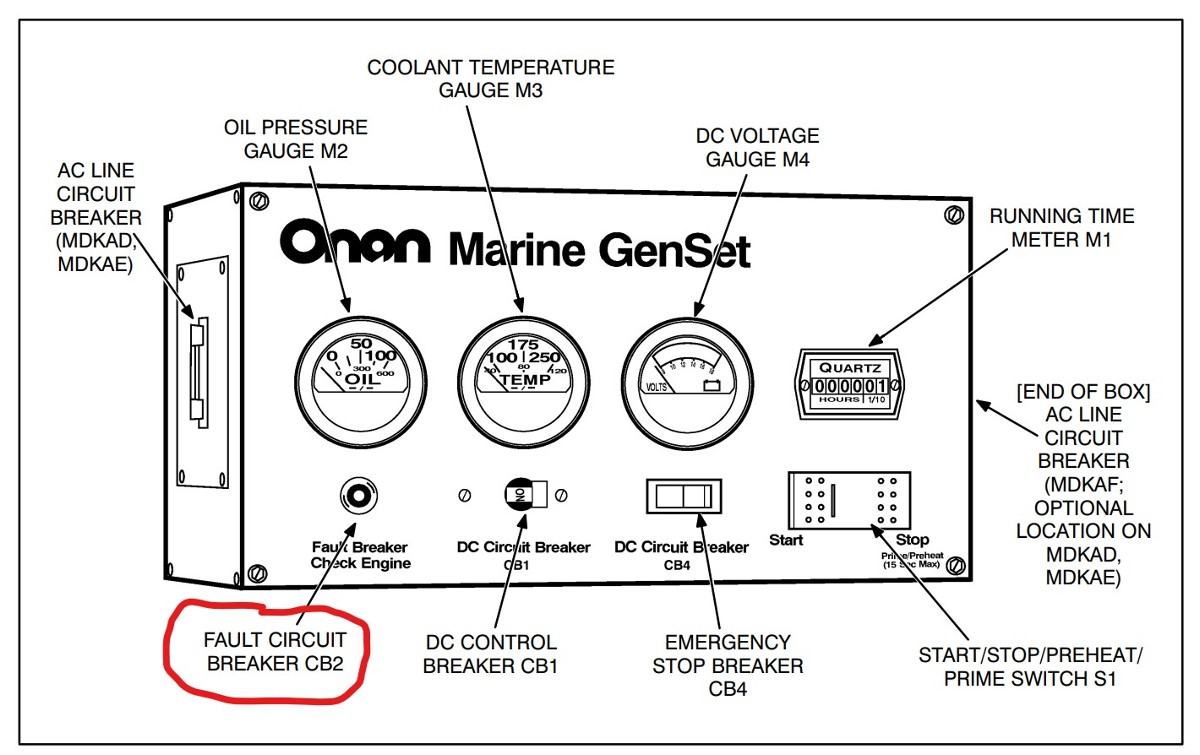

    One of our Onan 27kw (MDKAF) generators has started to randomly shut itself down. Sometimes it will run for 2 hours before doing so while other times it happens after a few minutes. Load doesn't seem to be an issue. Nothing has been done to it recently; its last annual service was in November.
    I did do a static fuel pressure test which was fine: 5.5 psi, within the range of 3.5 and 6psi.
    The other things mentioned in the manual that could shut it down:
    S2: High engine temperature
    S3: Low coolant level
    S4: Low oil pressure
    S5: High exhaust temperature
    While I don't think any of these conditions are occurring, it could of course be a faulty sensor. However, these conditions (when encountered), should trip the "fault condition CB2" breaker (picture below), but that breaker has always remained closed, even when the unit shuts itself down.
    Is my understanding of how this breaker works correct? Do the 4 conditions above trip this breaker when encountered?

    I do not believe the shut down sensors you list trip that breaker. If you have two of the same gen, start swapping sensors to see which one shuts down the other gen.

    Two good suggestions, thank you! I do have two of the same generators so I'll first check the HE and then start swapping sensors, one at a time.
