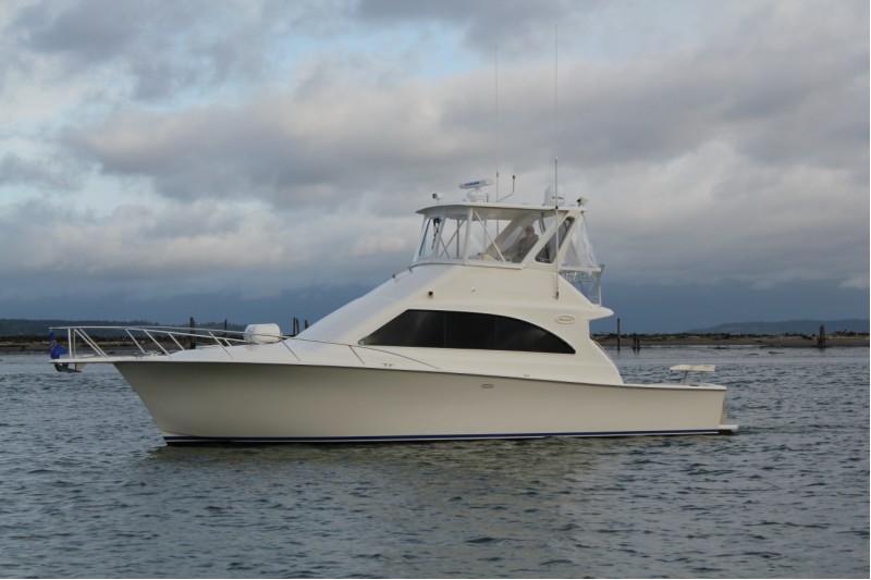

    Have a 40 SS 1998 that we purchased off Lake MI in 2007. Have done extensive updates to the boat and had the opportunity to become very familiar with the boat. In the 40ft range it is a very good boat with a unique layout. Tons of interior volume. Overall build quality is solid but not over the top. This model is a new gen Ocean with 14 degree deadrise and has a good balance of Ocean capabilities and efficiency with the CAT engines. The 3126 TA are 420hp and will push the boat at a 23-24 knot cruise. I have learned that it is very important to achieve rated rpm when loaded for engine longevity so taking a 1/2 inch out of the wheels can be a smart move. Burn rate at cruise is 26-27 gallons an hour for both engines. Hard to find a 40ft class Convertible that can post those numbers. Boat is 30k lbs wet. I would use this boat as a combo boat that does a good job of cruising and fishing. If you want a pure fish machine I would look at something better suited and likewise for only a cruising vessel.
