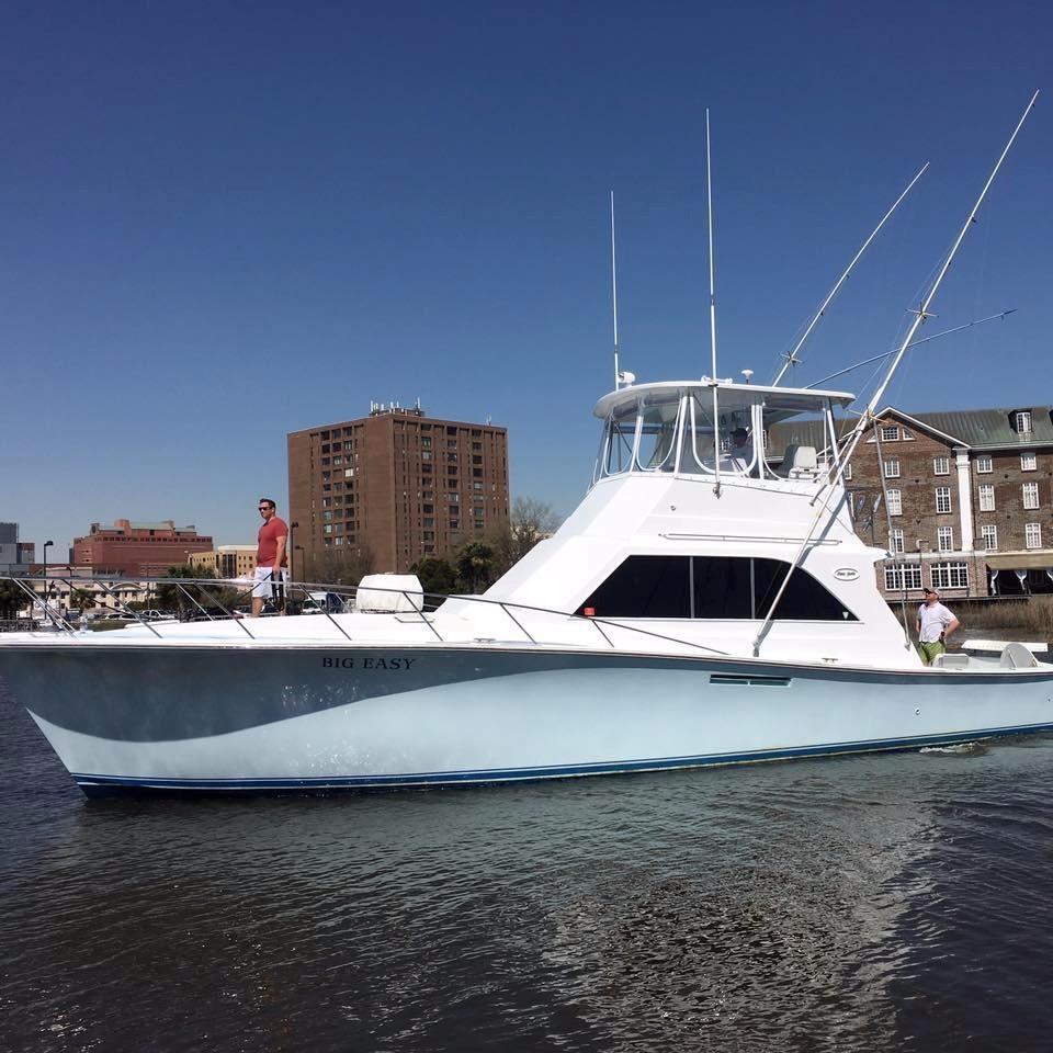

  18. Boomer
    Boomer Senior Member
    Oct 14, 2017
    677
    Seminole
  19. Capt Fred
    Capt Fred Senior Member
    Jun 22, 2009
    319
    Long Beach CA
    Great look 46
