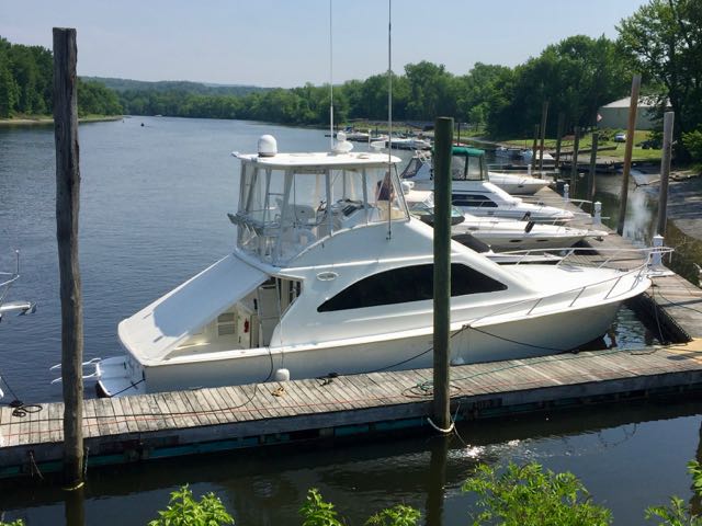

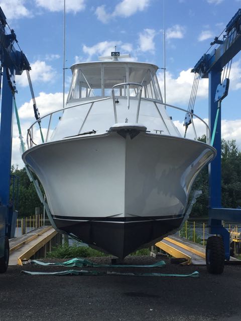

    Thought I'd add my new (to us) 43 to the forum. My wife and I were coming off a Tiara 35 Open and wanted to move to a convertible. We cruise, drink and fish, in that order. Mostly we wanted the improved visibility and living space above the waterline. We built a profile: 42-45 feet, 25 knots cruise speed, fish and cruise, 2 staterooms / 2 heads, no 2-cycle power, good aesthetic lines, a high(er) end build pedigree and a budget of around $250k. My 2-cycle power aversion mostly eliminated the top tier boats in production years that fit my budget: Viking, Tiara, Bertram, Hatteras. Ultimately we culled our search down to 3 choices: Ocean 43SS, production 2000-2005, Riviera 43C, production 1997-2003 and Tiara 43C, production 1990-2002 (with Cat 3196 in later years). I decided to stay away from Post, as much as I respect the build quality, but that's another story. We bought our Ocean after an extensive search and a lot of disappointment along the way. We crawled through far too many boats that were poorly maintained, overfished, run hard and put away wet.
    We got lucky finding this boat when we did. Upper Connecticut River, fresh water, only 300 hours on the mains and well maintained by a very knowledgeable original owner. She doesn't really need anything, but we're doing some upgrades this winter: Awlgrip the non-skid in cockpit, platform and gunwales, new EZ2CY, new cockpit bolsters, properly rewire the factory mess in the battery box, halogen conversion to LED everywhere, underwater lights and maybe add a 12v fresh water pump. And have to figure out something with a tender. The tapered beam at the transom limits choices here. Wish I had the hydraulic davit like Trinimax's, but cant justify that cost.
    Two things I'd change about this boat: More aft deadrise would dramatically improve down-sea handling and a bigger bed in the master to fit my fat ass.
    Counting the days to Spring here in the Northeast.

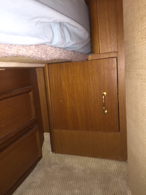

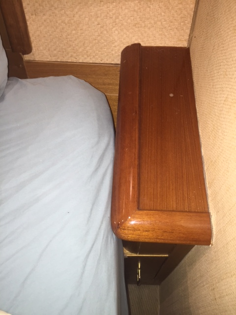

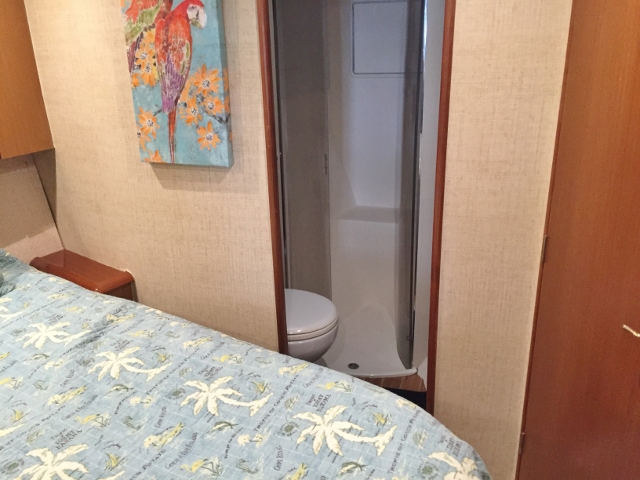

    Hi Tashmoo. here are some pics of the enlarged master bed. You lose most of the forward bed side table, but you still have enough space to pass to get into the forward head. will try to get some more pics of the actual extended bed structure when I make it to the boat later this week

    nice on the bed. Looks to add maybe 10". Does the mattress stay square all the way to the foot or does it taper to allow room to pass into the head? And is the pedestal widened along with all the drawer assembly under the mattress, or maybe just a ply underlayment to support the extra width? Any close(er) up pics would be great. Looks like a reasonably simple job to cut down the side table vanity

    Interesting. My wife and I are not all that big so no need for us to widen the berth. I too am curious of how they did that. Wondering if they actually moved the forward set of drawers beneath the berth "out" and then enlarged the plywood for the mattress or did they just enlarge the plywood, which would leave a pretty big "overhang" to access the drawers? Either way be prepared. As I've mentioned, removing the berth is a task. The plywood over the drawer assemblies was fastened down with heavy screws and 5200. Then the screw holes were putty'd over and painted leaving them impossible to find. At the head it was also tabbed in with fiberglass so I flush cut it and scabbed in new plywood. The only way I could find to remove the plywood was to rip it horizontally in 4" strips that I could then use a prybar to tear off. It was an absolute bear since I really needed to save the undercabinets. Removing the lower cabinets was a bit easier to get off as they were just screwed down. Here's a picture of the aftermath. I installed a teak and holly floor and most importantly an access hatch over the holding tank which you can see. IMAG0366.jpg

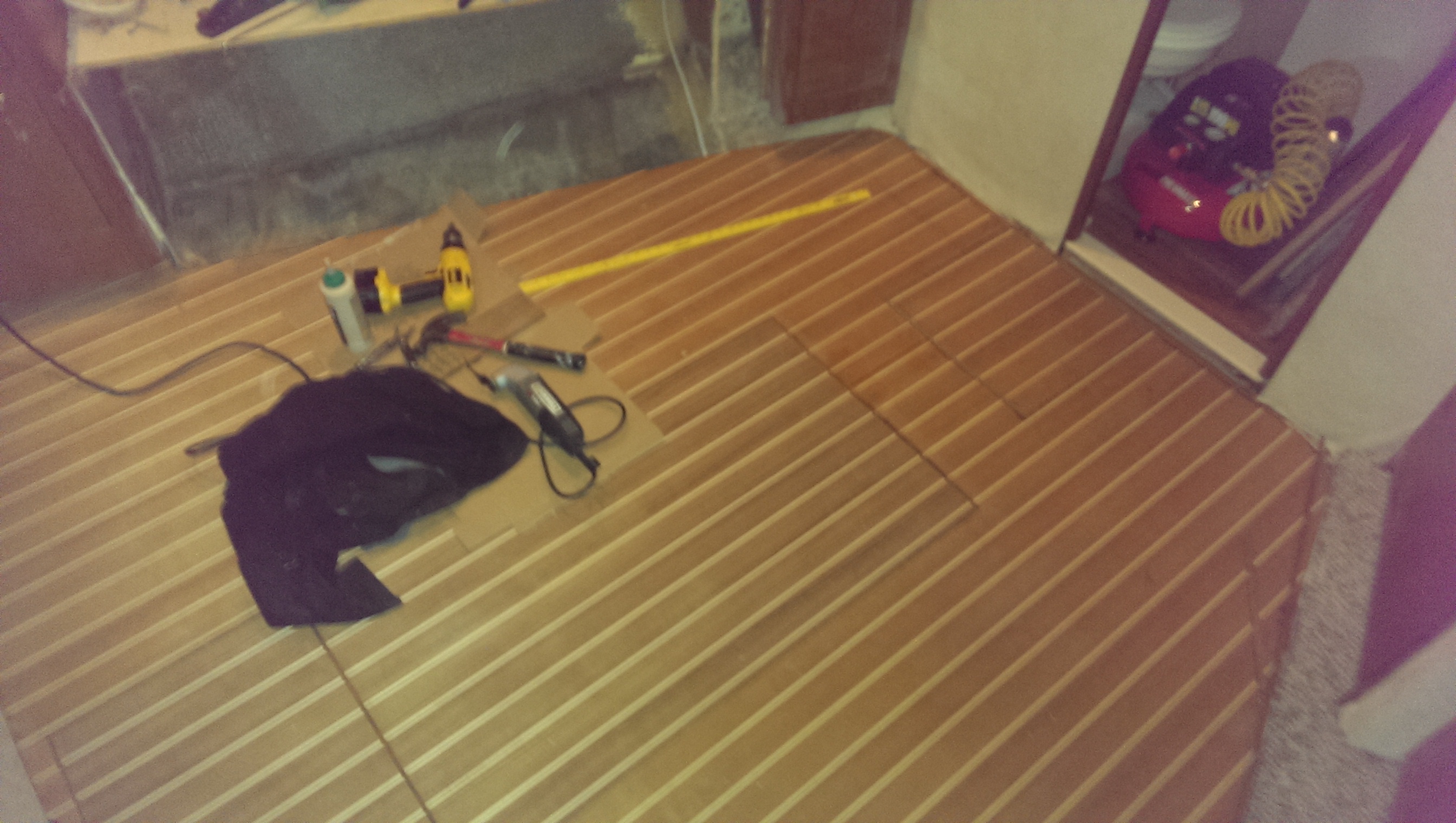

    Prospective the T&H sole looks great. Nice work. I've seen some of your woodworking prowess elsewhere too. I'm hoping that the job of simply widening the berth may be as easy as increasing the overhang with ply and rebuilding the forward side table. Simple stuff. Ideally I'd like to rebuild the under bed drawers to maintain accessibility, but it sounds like removing the berth is a major project. 5200??? Jeesh. Why the hell would Ocean Yachts want to make that joint permanent with no other access to the holding tank? LOVE this boat, but the things I'm uncovering in the build process as I get more intimately familiar leave me scratching my head

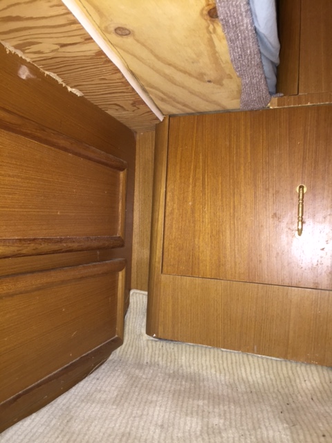

    To widen the berth I would use a circular saw set to half inch depth and rip the plywood base into strips that can be pryed up. You will also have to remove the end panel at the foot of the bed. Once that's all off you'll be able to unscrew the base cabinet and move it as one piece. You can cut the night stand to accommodate a new larger plywood base and also install a new end panel. A project but not too bad.

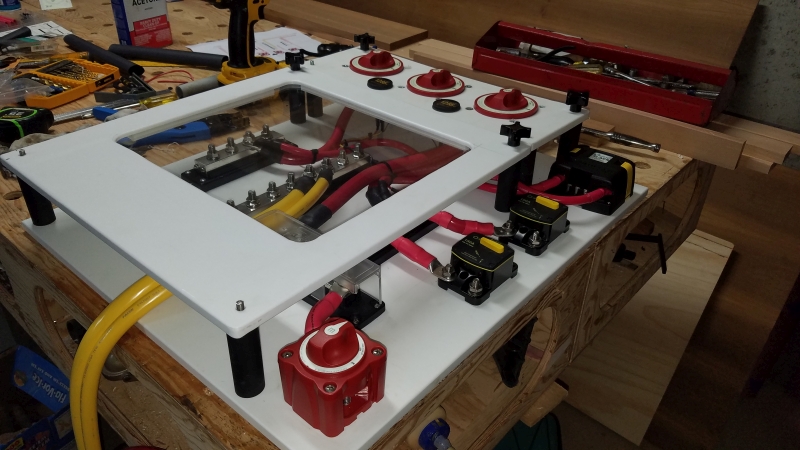

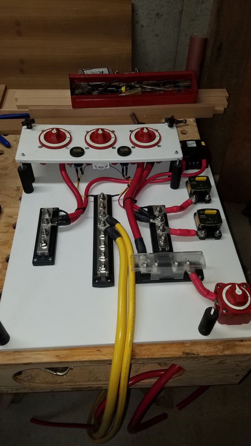

    Right now I'm working on a new DC distribution panel to replace the rats nest of wiring in the battery compartment. I will mount it all to the aft bulkhead of the engine room. I'll post some pics in case anyone is interested. Should be a big improvement.

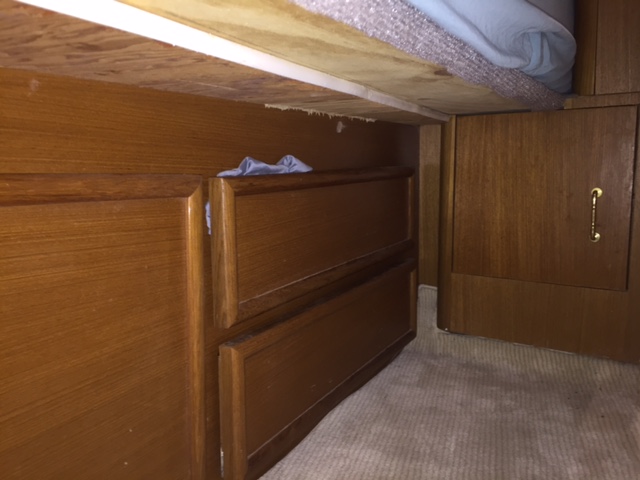

    Hi Tashmoo. here is the widened base from a few angles. from the looks of it, the previous owner put a new larger piece of ply on top of the existing base. the drawers below are still reachable. However the base is solid and there is no access to below the bed. Hope this helps and good luck with your project.

    Interesting in the pictures looks like they didn't move the berth drawers or even replace the plywood base (no wonder given how hard it is). They just slapped another piece of plywood over the top. No question this would be a much easier way to go. You also preserve the lower part of the side table cabinet. Only issue is contending with the increased overhang to access the drawers. You can also see the squeeze out of the 5200 between the original plywood base and the drawer base.

    20170207_080106.jpg 20170207_080231.jpg Here's a couple pic's of the DC distribution panel I built this winter to clean up the mess in the battery compartment. I wanted to do as much as I could in the warmth and comfort of my basement. I've already removed the giant windlass breaker, overhead light, and engine room outlet to clear space on the bulkhead between the Racor filters. Phase two will be to take it to the boat and mount it to the bulkhead and move all of the wires up to the panel and off the batteries. I'll do that while the boat is still on the hard. Phase 3 will be replacing the crappy Sentry battery charger with a Victron Inverter/Charger and also installing a battery monitoring system. But phase 3 will wait until the boat is back in the water in her slip.

    That's a really nice job on the dc panel. I'm still figuring mine out. The previous owner fixed quite a bit, so it's not what I hear the original mess was but still a bit hard to follow.

    Thats quite a nice panel there prospective. looking forward to seeing it insatalled. You have definitely inspired me to clean up my mess of battery wiring
