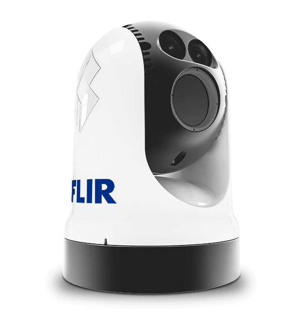

    The level of complexity of marine electronics is out of control
    in the past, FLIR cameras were pretty much stand alone with a wired joystick/control pad and a video output you could send anywhere. Simple. It worked.
    Fast forward a few year and raymarine comes in the picture converting the cameras to their network system. I had a camera installed on the 110 I took over... what a nightmare
    all i wanted is the cam output sent to one of the big daylight monitor which can accept hdmi, video, RGB etc.
    Sorry... not happening. You need to get a video converter from raymarine.
    no big deal, right? Wrong. To configure the converter you need to use a windows PC running near defunct internet explorer with the obsolete Silverlight plug in! You also need to download and install a configuration tool to look up the converter IP address so you can open the converter setup and enter the camera IP address.
    To make things worst once in a while the IP addresses change and you have to redo the whole set up.
    Oh and raymarine didn’t want to spend a quarter on a power on LED on the optional control pad so the only clue that the camera is powered up it the red backlit on the control joystick. Which you can’t see during the day!

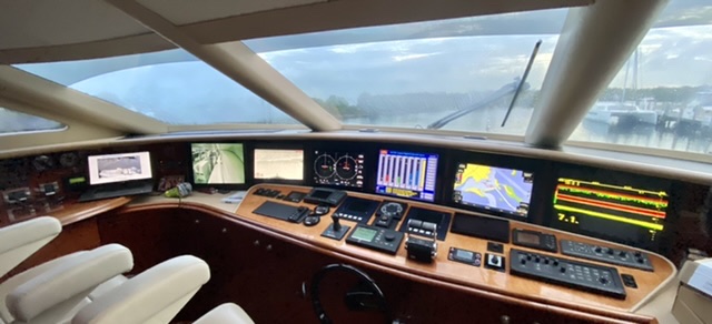

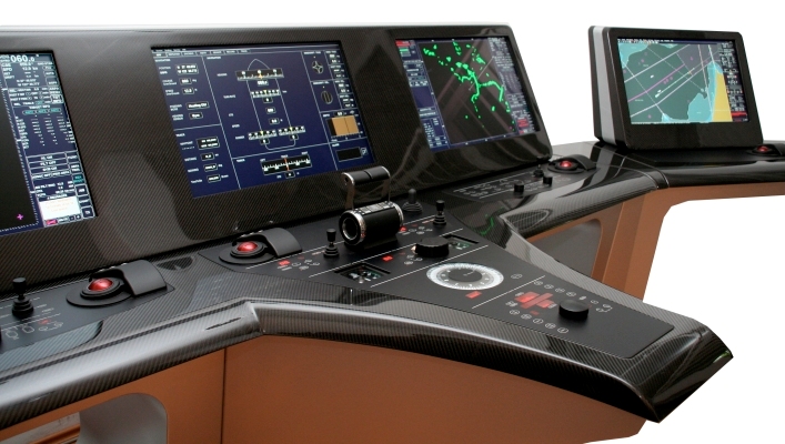

    The thermal cameras are intergrated into a Raytheon Anschütz integrated Synapsis NX glass bridge with multifunctional workstations. The FLIR systems are perfectly integrated into the bridge and ships network and work absolutely flawless.
    I am not the type of owner, who opens electronic panels and tries to work on the fancy staff and wiring behind the panel. Even my Chief would rather have the service rep from Rhaytheon-Anschütz coming to the boat, then screwing around with the system. But up to now there was no need for that. This complicated and expensive equipment needs to be worked at by professionals. And very important, system integration needs to be done by a single contractor and with Raytheon-Anschütz, I think I have taken the best. Btw. they are the Lürssen and Abeking "purveyors to the court" for most of their yachts.

    that s the problem. This new FLIR is an IP camera and doesn’t have any video out port
