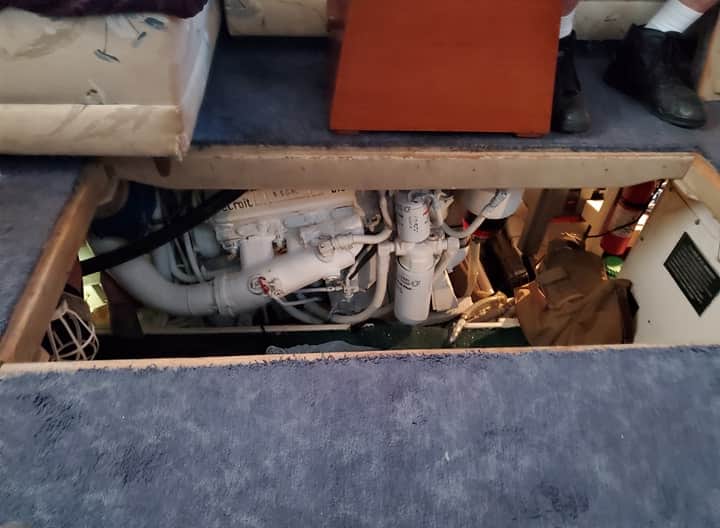

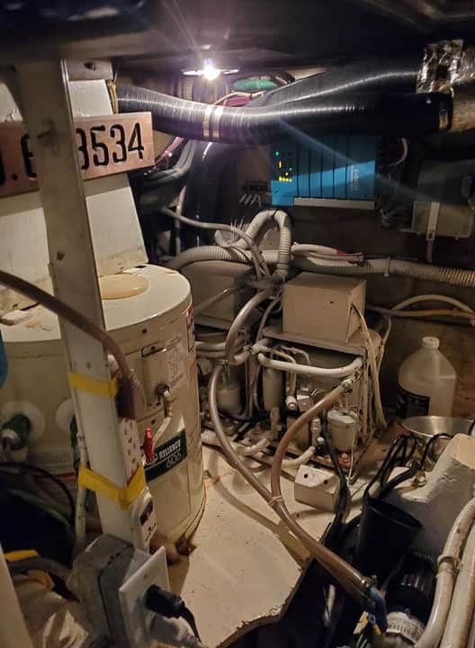

    Boat has heavy growth. Owner says she's a jewel. Bilge appears clean and tidy. Says the exhaust needs work. Leaks when running. Soft spot in floor by the opening where bunk beds are. I believe it hasnt been put on hard in a few years. Theyre asking 50k

    Sounds Ok for 25/30 K. IMO. $50k is to high.
    Motors will need to start and run, along with sea trial and survey . To be sure they will need all new filter though out, new oils through out, new coolant ,etc...
    soft spot sounds like a leak from above hatch , window or rubrail OR who knows what, but probable not a big deal. I would count on changing out the generator soon, even if it runs. Parts are hard to get.
    All air conditioners should work, check them since it's in the water. Check everything for that matter since it's in the water.
    The boat may have been a jewel, but sitting around in or out of the water for years is not a great thing, but not a bad thing either if you get it for 30K.
    To me from your pictures it's worth a look.
    All offers should be contingent on a sea trial and survey.
    If the seller is serious , they should do all of the motors maintenance( oils filters etc) for you BEFORE the sea trial .
    And look over the full tanks REAL good top , bottoms, sides for leaks, rust, holes etc.
    Insist on full tanks, fuel and water, to see if they leak. that is the only real way to find out.
    Look over the deck fills and hose to tank connections, tank nipples for rust, holes and leaks. there are usually service access panels for get to those locations, they may behind something like furniture or drawers or what have you, but they are there for service if you had to change out a fuel line or tank sender.

    New info: the 23yr old survey said the 692 motors had 2,044hrs on them. The hour meters now say 2,320hrs.
    The owner states the exhaust leaks are too big to start engines. Not that he doesnt want to, just he doesnt have the money to pelace the exhaust and run them.
    After looking at a couple old Post boats i can say this one is in really good physical shape.
    The bilge through the whole hull is dry as a bone and clean as a whistle.
    All the hises show no signs of rist or leaks
    The engines have no oil leaks under them
    Everything is tidy and neat and nothing looks hacked.
    The only rott on the deck is a 3' area around the pulpit. Which was far less than all the others i looked at.
    The rear bulkhead is solid
    The side windows have a little delamination in the corners but are solid.
    Both ACs work and blew ice cold on a 100 degree day. 2 days ago.
    The san system needs service.
    The interior is original and in very good condition. Carpet needs replacing but all wood fixtures are great.
    One side window is cracked and needs to be replaced.
    He's willing to go down to $45k with him doing zero to the boat.
    Hes been in and out of hospital and is very sick.
    The awsome slip he has is in boston Harbor over looking Boston. Its $1,500 a month with all services. I found thats half the cost of the surrounding marinas in the Cape.
    Comes with a nice fighting chair and the parts to make up the faulty exhaust pipes.
    Im going to pass because I'm not confident enough in my experience with boats.
    Ive spoke to surveyors and looked at a few if these and this is the cheapest one on the east coast and the nicest one out of all of them.

    1) The motors have run 300 hours in 23 years??? What's wrong with that picture?
    2) A 23 y.o. survey has zero value.
    3) Motors that don't run don't leak. So that has very little meaning.
    4) If you are unable to start and survey the motors do you have a spare $100K or so to replace / rebuild them?
    5) Have you confirmed with the marina that the slip is transferable with the boat. No marina I know allows that. Most marinas have waiting lists of people who give money under the table to stay at the top of the list.

    If I were not permitted to test run those engines etc. I'd be putting that and the genny on my balance sheet as the cost of rebuilds. Actually unless the boat was truly a "jewel" I'd walk away if I couldn't test run the mains.
    I'd view this boat, even without visiting it, as a handyman special from the little I see in those pics. If your not handy, figure the cost of tradesman $$. If you're handy, you'll be busy. If you truly luv the boat the cost/sweat of refinishing isn't as important as the final product.
    Post's are well made, lovely boats. Old boats will take luv and money. Is the $50K ask reasonable? Dunno. But you'll have a good idea from the other boats you've been looking at.

    If it was me, I would ask if I have permission to start them, turn them over with a hired mechanic. Just check all the fluids etc hook up an 8D battery to the cables and turn them over first to see if they well do that , then try to start them up.
    Hook up the fuel line after the Racor fuel filter , dump that line into a few gallon jug of fresh fuel and see what happens . You can run it shortly to get an idea if they are good or bad even with leaky pipes ... Work the sea cocks first just u case .... Make sure the bilge pumps work to .
    My gut says its a good boat , motors too.
    Bet you can get the boat for $40k ...
    If know one is allowed to start her up, it's a 10k boat...and probably will never sell, not at $60k...
    Some times you just have to Boss Up and go for it.

    these pictures caught my eye, especially since i now own this boat haha. i can say the bottom growth was heavy, the seller was over bearing and a bit of a pain to deal with. i shot him an offer in person with cash and he took it. i hired a diver to scrape and clean the bottom of the boat and perform a hull inspection.
    i serviced the engines and the generator, replaced both mixing elbows off the turbos on the mains, rebuilt both turbos due to being stuck from sitting and also replaced both raw water impellers. less then 24 hours after hearing it run for the first time we ran the boat home to the connecicut river through the cape cod canal. for a boat that hadn't run in years the thing fired right up and we have made several trips with it since then. we purchased the boat beginning of august and had it sea worthy and heading home 5 days after purchase.
    sometimes you have to take a gamble and just go for it, i guess i lucked out!
