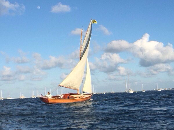

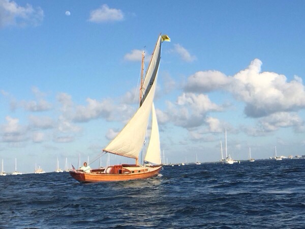

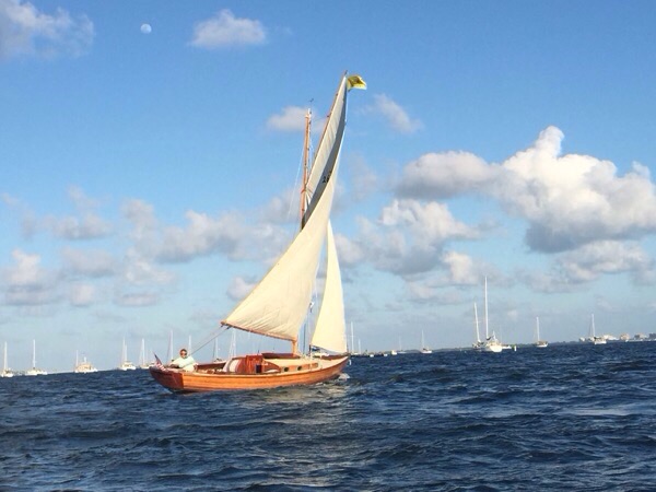

    image.jpg image.jpg Judging by your avatar you have good taste in boats and cars :)
    How old was the mast, how was it built and where was the actual failure? Was it the mast it padle or was it the rigging (stays)?
    Obviously an alum mast requires less maintenance and will be easy to find but whenever I see an alum mast on a nice looking classic... I cringe. :)
    I built a 32' wooden mast for my 26' classic gaffer a couple of years ago. I used the birdmouth method with doug fir. Took me about a week. The cost is the labor not the wood which is pretty cheap. I went back and forth between wood and alum. And just couldnt resort to alum on a classic boat with visible wooden hull.

    Thanks for all comments! Boat and mast are same age, from the 1950's. Failure was right at the point where the spreaders connect. I definitly do not want to spoil the look, so after talking to a "rigging expert" he came up with the proposal of an white aluminum mast (Selden), as the current one is also white, and then the look would not change. But true, it would not be "pure" but simpler... Ad Pascal: if wood, then it should be visible wood with clear finish like yours, not painted white (like mine)!
