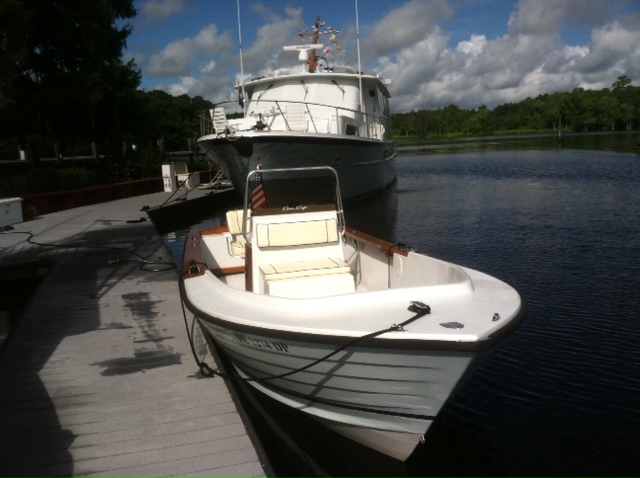

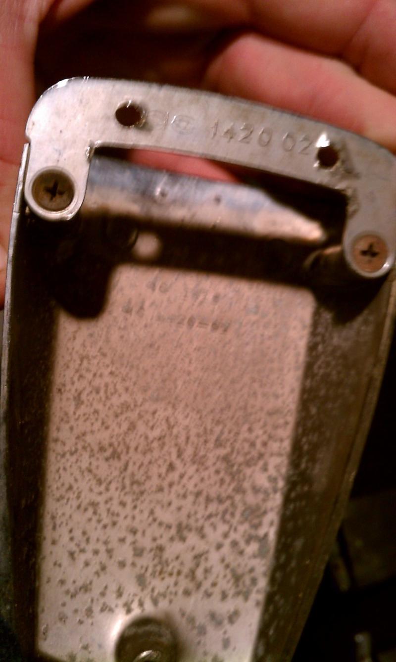

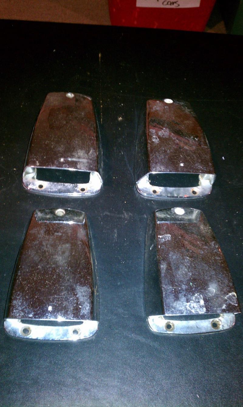

    Have been busy contemplating old boat mysteries as finishing tear down and foraging for miscellaneous parts.
    I still am looking for some good pictures of what the "OEM" woodwork looked like on the console and forward locker doors. Was it mahogany as was used in most Chris Crafts of the era as I've been told?
    Today my order is going in for new "OEM" rub rail from Wefco - after much agonizing I have decided on OEM gray over black or white, thinking it will give the best balance in appearance v. maintenance.
    Recent victory pictures below - expected to arrive today so I can chase replating...

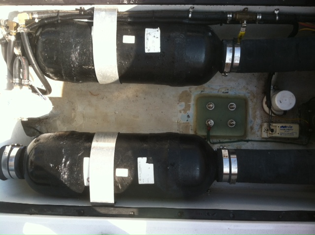

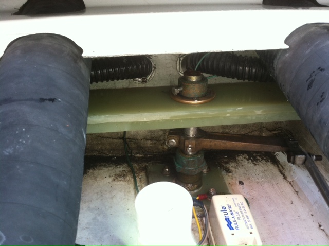

    G10 backers for strut and rudder post
    Here are pictures of G10 used to back up the strut and the rudder post. We epoxied two pieces of 1/2 inch board and tied it into the struts to support the upper end of the rudder post. I think this is a much better solution than the starboard used by the PO, who used no upper support on the RP BTW.

    I love that setup! Can't believe I didn't do that. At least up until now! We will be making that mod immediately. I am looking into the platform specs and will get back to you on that. Send me a PM as to what you are looking to get for it.
    Great job.

    That does look far better/stronger than what's in mine (which is basically nothing but the rudder shaft extending about 4" above the bell crank)... I believe I'll install this mod, too, as soon as we have the stripping out of stuff done to clear the space. I second the good job kudos.

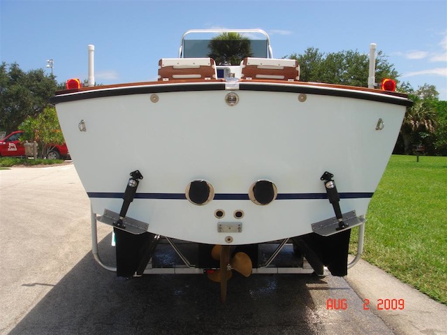

    These boats are very heavy in the aft with a high bow to try to see over. Mine came with 12" by 9" Lenco tabs which don't get the job done. I have been working with Bennett on the issue and they recommend 24" by 9" or 24" by 12". Having the benefit of 20 or so hours of use, I am going to switch to 24" by 12".
    The picture is with the Lenco 12 by 9s showing how much area is available for much larger tabs.

    Rudder: Agree with Al, great innovation on the rudder stabilization. Like Mike, I just have to shaft sticking up out of the stuffing box. Is that a sensor on the top there that indicates rudder angle to the console?
    Trim tabs: I could see the desire for theses..... I find the trim issue to be particularly challenging with a full tank of gas and a load of passengers. In the end I did not install these as I thought effectively attaching them was going to be difficult.

    That green wire is a ground. I had to buy a new bushing and collar for the RP mod.
