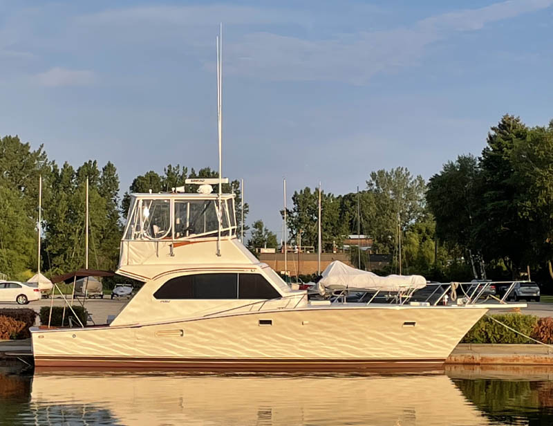

    Long time listener - first time caller.
    My wife and I took delivery of 43039 (1985) two weeks ago in Green Bay, WI, and cruised her home to Grand Haven, MI, in 6' following seas on Lake Michigan, day 1. Quite the learning experience. Freshwater boat, heated winter storage her whole life, clean survey and both Jimmys are 440+ compression at 900 hours. After an exhaustive search for an 80's - 90's diesel convertible, we couldn't be happier. Slim pickings in the rust belt for quality offshore boats.

    Welcome to YF Tight Lines. Pretty Post! I reduced the size of your pic from 3400 pixels to 800 pixels so it will display better across various devices.

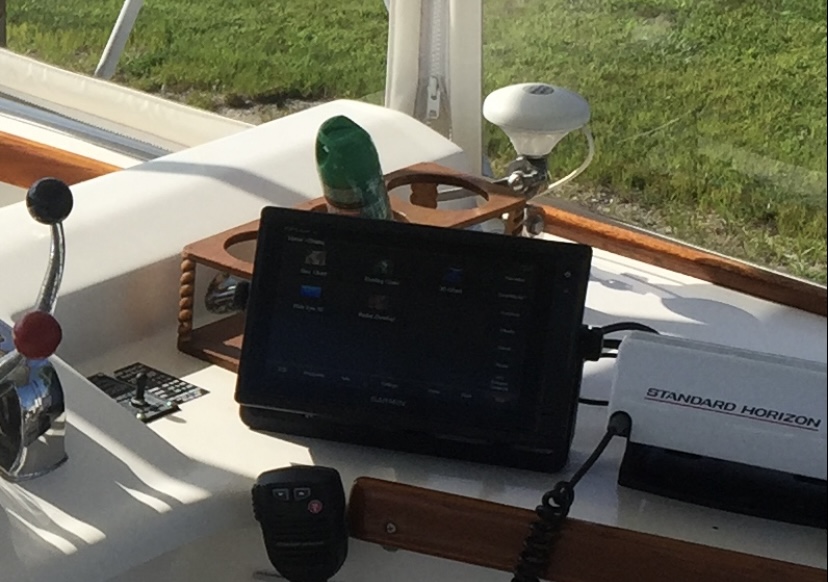

    I have a regulator mounted under the gunnel as the very first thing dockside connects to. I have no idea what pressure it is set at. Now I feel like I have to know!
    You may consider life calk for the holes - sandable and paintable and might be easier to remove as a temporary solution than 5200. Whatever you choose if it was me I’d make that my first priority and I’d probably have a tarp over my deck until I was sure I had it under control.
    Previous owner put a wooden cup holder on bridge with multiple cup holes. Finish matches rest of teak trim and Blends in well. I’ll try to find a picture.

    Cup holder
