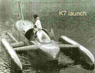

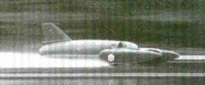

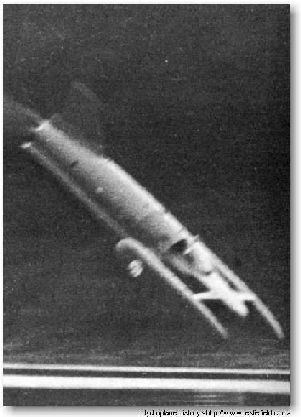

    Looks alot like Donald Campbell's ill-fated "Bluebird" (K7) to me. :(
    Some history/details:
    In January of 1967, Donald was trying to raise his own record to 300Mph on water, when the K7 flipped spectacularly at Coniston water. He had achieved a one way run of 297Mph, but he turned K7 around without refueling and without waiting for his wake to settle, he set off on the return run. The boat lifted out of the water after exceeding a speed of over 300Mph, somersaulted and nose dived into the water disintegrating on entry. Donald's body was only recovered in May 0f 2001.
    Overall length………………………..26 ft 4 ins.
    Overall beam………………………...10 ft 6 ins.
    Overall height………………………..4 ft 8 1/2 ins.
    Length of floats………………………12 ft 3 3/4 ins.
    All-up weight…………………………2 1/2 tons (approx.)
    Construction...............................high duty 'Birmabright' light alloy hull,
    built around a high tensile tubular steel main frame.
    POWER UNIT
    Make & type……..Metropolitan Vickers "Beryl" turbo-jet engine of Straight-through design
    with: 10-stage axial compressor, single stage turbine.
    (Later replaced with a Bristol Siddley Orpheus from a Gnat fighter plane)
    Dimensions……….11 ft 9 ins. Long, 3 ft 2 ins. Diameter, 1780 lbs. Weight
    Thrust…………….4,000 Thrust-lbs (Beryl). Sea level static at 8,000 revolutions per minute.
    Fuel……………… Kerosene, stored in a "saddle" tank.
    Consumption……. 650 gallons Kerosene per hour; 3 tons of air per minute.
