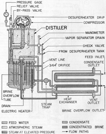

    Fleet submarines in WW2 and through the 1960s used a Badger vapor compression still to produce potable and battery water. Badger stills were first patented in 1936 and were perfect for submarines because they used far less power than other low pressure evaporators and because they were DC powered, could be used when submerged.
    The were hot and miserable to manage, the sound of the roots compressor was obnoxious. They were used most often in tropical waters where battery water consumption was highest. The heat they radiated into the engine room along with the heat coming off the main engines after submerging made life very uncomfortable.
    Maybe Kamen fine tuned the process and repackaged it to look more like an Apple product but it is far from an original stroke of genius except perhaps for the marketing aspect of an old and well proven technique.

    "Vapor compression consumes the least energy per unit of distillate produced compared to other evaporative techniques but it still consumes at least twice as much as RO."
    That was what got my attention ... only he can answer that one.
    http://www.desline.com/geneva/banat.pdf
    It takes X amount of power to change the phase of Y amount of water plus the power to compress vapor to Z temperature and pump the feed, distillate, and reject someplace so the only thing I can figure is it doesn't make much product water.
