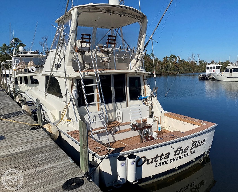

    upload_2022-6-24_16-5-2.jpeg ,

    Sounds like a full coverage isn't really worth your money, with a limitation like that...
    Also because I suppose it might be hard to agree an insured value upon a '73 boat, no matter how well maintained.
    Which she does appear to be, by the way. Congratulations!
