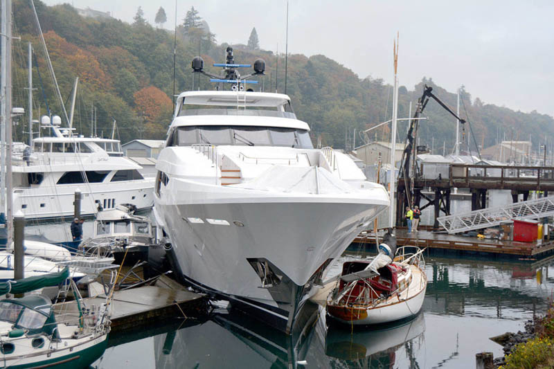

    Article said it was tied to the fuel dock. Ripped the cleats off the dock?
    First reaction is why didn’t someone killed the engines but if it was tied up maybe nobody was at the helm? And even if someone is at the helm, do they hope to quickly regain control... at point do you shut down and loose hope to stop
    Tricky. But way too frequent

    Electronic controls? Wireless controls? By the way, the fuel dock in Port Angeles is on the west side of the marina, the boat ended up on the east side ramp.

    And what do you know about the damage to the 125? I couldn't see it from the photo.

    The damage is cosmetic, nothing structural.
