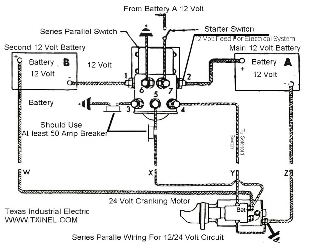

    Thank everyone for their responses. I started the process of moving my house power off my mains. Figuring out how the mains work with the 24v starter was easy. + from battery 1 goes to the starter solenoid, and the other side of the solenoid goes to the neg. of battery 2. Battery 2 + goes to the starter. My question is about the charger. The charger has been replaced. It's a 3 bank charger with 3 positive outputs and only one common. One bank for each of the two mains and then one for the Generator. I tried tracing this out and found where the original charger was, and its wiring was intact. The new charger is wired to the original wiring at this spot. How does the single 12 v bank charger, charge up the two batteries on the main? The charger looks like the wires go into the electrical distribution panel. When I turn on the charger, the voltage on both batteries goes up to 13.8v, and 12.8 when the charger is off. How did these systems work? Even the alternator seems to be 12v, but I haven't tested this. I'm pretty good at electrical stuff, but this confused me, and since I can not trace those wires out, I'm not sure what to look for.

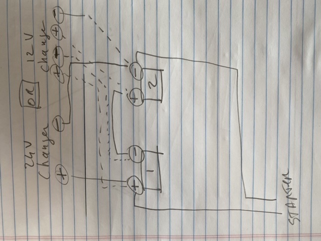

    0E7FC2FE-E239-4022-B299-4E06CFE6A02E.jpeg This sentence doesn’t make any sense at all:
    “Figuring out how the mains work with the 24v starter was easy. + from battery 1 goes to the starter solenoid, and the other side of the solenoid goes to the neg. of battery 2. Battery 2 + goes to the starter. ”
    Both batteries should be connected in series, pos to neg to produce 24v
    Positive terminal on the bank goes to battery switch and then to starter, negative goes to engine ground.
    mid both battery pos got to starter you ll have 12 volts at the starter with 2 batteries in parallel
    Assuming you connect both batteries in series to power the 24v starter, then your 24 charger should be connected with a single output wire to the positive of the bank, and the negative to the bank negative
    if someone used a 12 V charger, you can make it work by sending each charger output to each battery. Not ideal but it will work.

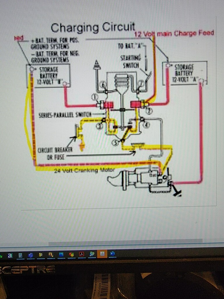

    both of you, thanks. Pascal, what I have is the starting solenoid between battery 1&2 so the 24v charger can not work. The two bank charger will work but not with a common - for both banks but that is what is on there. I have two mains and two Generators. The Gen batteries are one for each Gen. Only only one was connected to the charger and that was direct to the battery. I think to make this simple, I should have a 4 bank charger on the mains and then a two-bank on the Gen sets. House power comes from the Gen batteries. Right now House power is coming from battery 1 port and stbd.
    The alternator from the motor looks to be hooked up to the house battery only. 12v.

    All, I had figured it out yesterday. This is a 24v starting system. The solenoid between the batteries ties the positive from battery 1 to the negative of battery 2 and then over to the starter. The key is when the solenoid drops out. There is an aux. contact that makes contact, making both batteries parallel for charging. Alt. is a 12v alt. I have attached the solenoid drawing. The top half works like a normal starter solenoid. Terminal 1&2 close when starting. When de-energized Terminal 1&3 becomes closed and so does 5&2. Then the 12v alt. on terminal 2 will charge both batteries. Pretty darn interesting. BTW, I am not an electrician. I am a controls engineer. Been doing this for a long time and haven't seen anything like this in over 30 years. This stuff was done on generator protective relays that I had worked on back in the 80s. I did find those two drawings on the internet, just had to dig past pages of advertisements by Google. I really want to thank everyone here. Without these forums, jobs would be much harder and I hope I can contribute. Any more questions on this, let me know. I feel like I have a better understanding now of the starting & charging system. Now off to figure out the emergency starting system and how this ties the two banks together. I will post this on another thread.
