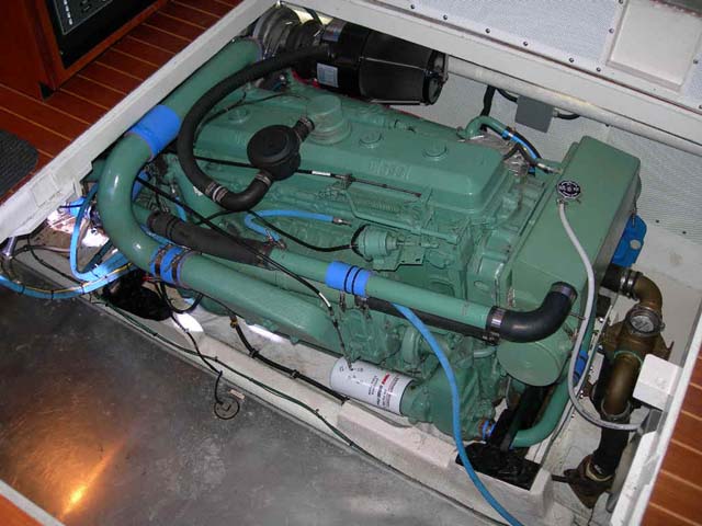

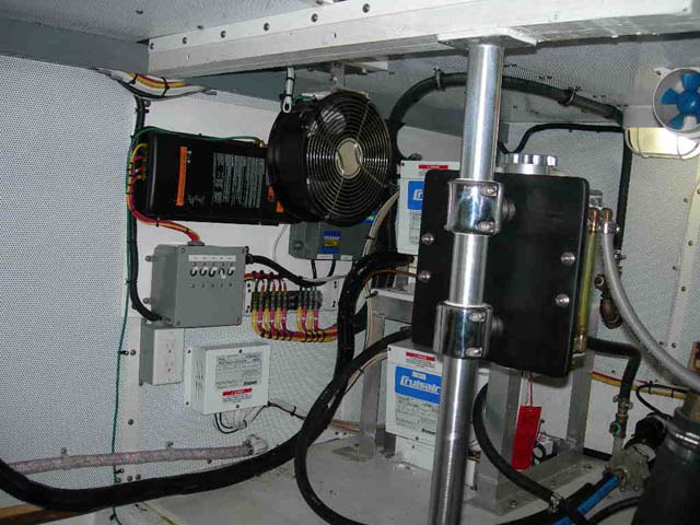

    Read some comments about getting more members involved so I thought I would introduce my 1976 Post 42. She's hull number 38 and I have been restoring and improving her for over 4 years. I am in the marine trades so I have access to materials and resources that have made this somewhat "cost-effective" (my delusion. My wife has another opinion.) and I have done all work myself as time and money have allowed.
    I replaced the original steel fuel tanks with .250 aluminum tanks and did so without cutting up the cockpit sole or any other "major surgery". I'll spare you the details of just how but it worked out slick and the boat stayed in the water at the dock the entire time. I replaced the entire fuel system from the deck fills to the new Aeroquip fuel lines to the J & T 6-71Ts.
    When the tanks were out I fabricated all new decking surfaces in the engine room using 3/4" marine plywood glassed on all sides in 6oz cloth set in WEST epoxy. I removed all electrical wiring, plumbing and air conditioning compressors. I removed all the old fiberglass insulation and screening and installed 2" Soundown accoustical foam with lead barrier and covered it with Soundown perforated aluminum sheet.

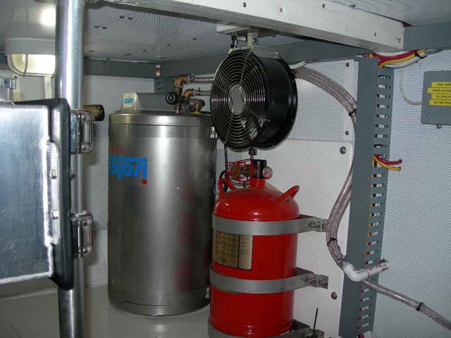

    I replaced the original wood support posts with custom aluminum pipe supports (just because I wanted to) and now have 2 new 16KBTU Cruisair compressors stacked, new battery chargers, added internal sea strainers (2- 1/2" Groco), Fireboy extinguisher, and Isotemp hot water heater.

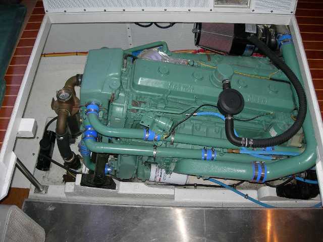

    I replaced all the hoses, clamps, and piping on the 6-71Ts, tore down the heat exchangers and rebuilt, installed new turbos and new blankets and converted to closed crankcase system (Walker Airseps.)

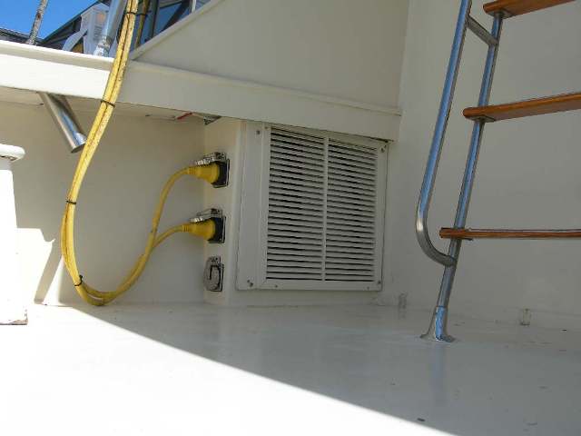

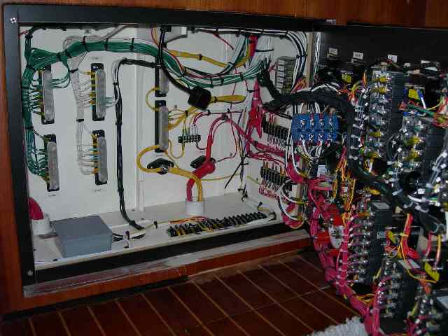

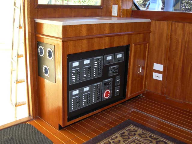

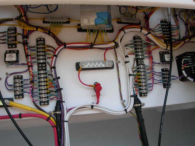

    I removed the original 12VDC and 120VAC panels under the steps to the galley and converted the wet bar/ice maker in the salon by the cockpit door to the new power distribution panel. New 12VDC and 120 VAC panels by Blue Seas Systems. Over 1000 feet of Ancor marine grade tinned wire and over 600 Ancor waterproof (heat shrink type) terminals later...... new wiring system to ABYC standards. I even relocated all battery switches to a custom panel by the cockpit door. I stayed with a dual 30AMP system mostly because I didn't want to lug a 50AMP shorepower cord and couldn't afford a Glendinning Cablemaster. I am using 2 Charles isolation transformers in the shorepower system.

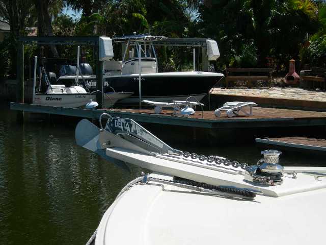

    New plumbing system nearly complete. New windlass - Lewmar V-3. I shortened the ridiculously long original bow platform (looked like a swordfish boat) and mounted a sturdy bow roller and Delta anchor with 60' of 3/8" hi-test and 400' of 5/8" 3-strand.

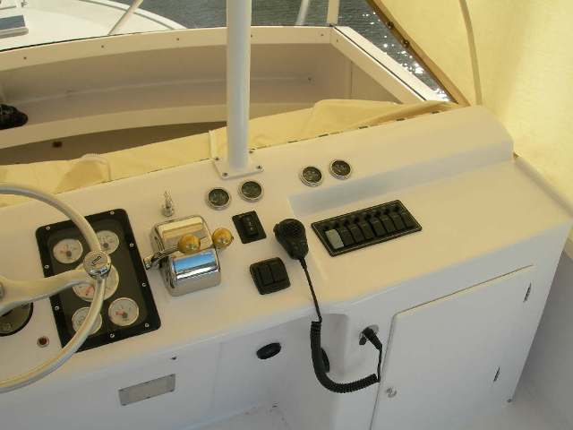

    I removed the helm from the flybridge as well as the fore and aft seat on the port side. There was extensive rot on the balsa core on the flybridge and I had to remove quite a bit of it. I removed all the original cleat stock and fasteners, including the shroud. I replaced the balsa core with new balsa core (I have my reasons) and built up the deck with alternate layers of knitted glass cloth/balsa all saturated and set in WEST epoxy. Much time spent in fairing this out. Not fun. I completely stripped the helm and repainted it and then installed all new guages, new wiring and new throttle and gear levers. I added pyrometers to watch the exhaust gas temps. I glassed in the hatch covers in the front seat and side seat and installed watertight Bomar hatches so as to eliminate the water intrusion that would get inside the helm. The side seat, the helm and the shroud were reinstalled using biaxial cloth and WEST epoxy. There are NO fasteners penetrating the flybridge deck except the new helm seat pedestal which is throughbolted through a thickened epoxy annulus.

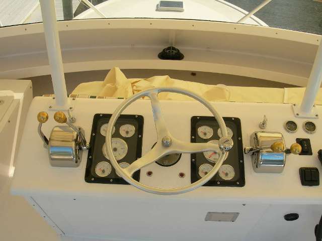

    I have a full tower (original Pipewelders) so I replaced the helm top and the throttle/gear levers and I replaced all the cables from tower to helm and helm to engines/gears. I also replaced the cables for the emergency shutoffs (air box dampers). I replaced the lexan venturi (windscreen) on the helm with new smoked lexan and sealed all joints for watertightness.

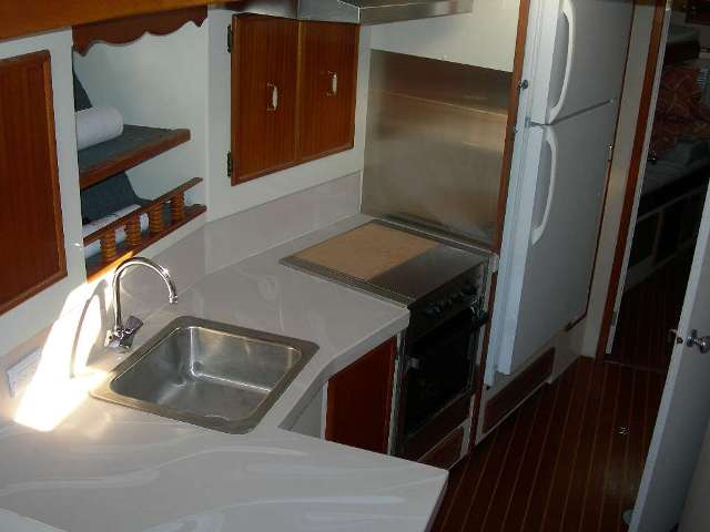

    New fridge and stove in the galley. New ceiling in the salon and master stateroom. Deck hatches were removed, stripped, new lenses, gaskets and hardware. Aft cockpit bulkhead on port side was water damaged and was replaced (sounds simple on paper.)
    New shelves were fabricated and installed for the new rudder upper bearing blocks (under the aft cockpit.) New Tides dripless shaft seals were installed on both rudders (upper bearing blocks also by Tides.) New shelf was also fabricated for the hydraulic steering cylinder. All new steering system - Hynautic cylinder, relief valves, reservoir, oil lines and HD helms.
    I hauled out about a year and a half ago and replaced one shaft and coupling and installed Tides dripless shaft seals on both shafts. While out I also replaced ALL existing "seacocks" with proper through-bolted seacocks. There were a few gate valves that looked scary and not a real seacock on the boat - alot of ball valves screwed onto mushroom thru-hulls.
    I removed the bow railing and the aft flybridge railing along with a few other handrails. When the budget allows I intend to have new aluminium railings fabricated and installed. I would also like to replace the ladder to the flybridge. I fabricated a hatch over the opening to the flybridge and modified the old ladder to suit and it's working for now. But I'm afraid one day one of those teak steps will break when a big guy climbs up there.
    New canvas and new cushions of course. New underwater lights on transom. New blue LED courtesy lights cockpit and flybridge. Still working on the some of the interior finishes and I'm saving up for a new genset so I still have work to do. I figure I'm about 90% done (if a boat owner is ever really done....)
    Sorry this is so long - it's hard to quickly describe over 4 years of work in a few lines. I've got lots of pictures but I will start with just a few of the more interesting ones.

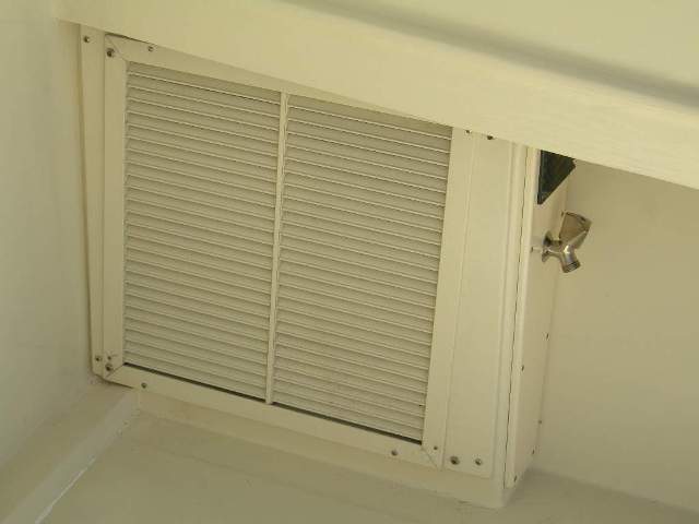

    The previous owner removed the large hullside vents, glassed in the holes and faired it out prior to painting the boat. To provide ventilation to the engine room there are two large louvered vents in the cockpit in the area near the shorepower inlets and fuel fills. This seems to provide enough air to the 6-71s but I've never actually done the calculations to determine if there is really proper airflow. I run both blowers while underway to try to draw as much air as possible into the engine room and the engines seem happy enough. I'm glad I don't have the big clamshell vents on the hullsides but there are some drawbacks to the venting I do have, including a minor nonconformity to ABYC standards (venting too close to fuel fill.)

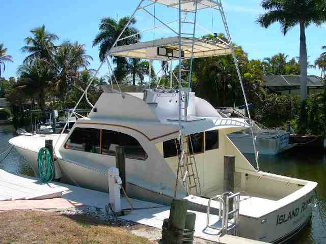

    More 42 Post Photos

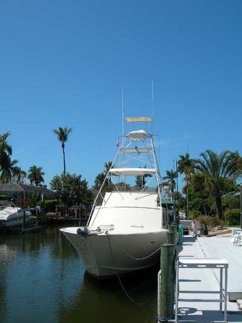

    For those who are still interested here are a few more photos of my 1976 42, hull #38. These are some exterior shots.

    Nice How do you like those spray rails? Was the cockpit always so clean of cabinets?
  11. Island Runner
    Island Runner Member
    Mar 13, 2010
    77
    Florida
    The boat had the spray rails when I got it so I can't offer a comparison of what it would be like without them. They are teak and require maintenance at haulout so I wouldn't choose to have them unless I thought they were necessary. And maybe they're not really necessary, I don't know. I would be interested to hear from other older 42 owners with and without spray rails.
    The cockpit had no built-in cabinets. There was a free standing tackle rigging station that was old, wooden and riddled with insect and wtaer damage. It was broken up and thrown out. I would love to have built-in cabinets for tackle storage, rigging, cleaning stuff, docklines, etc. but the engine room air intakes make that a challenge. I have a large cooler I put in the cockpit against the starboard bulkhead and otherwise the cockpit is clean.

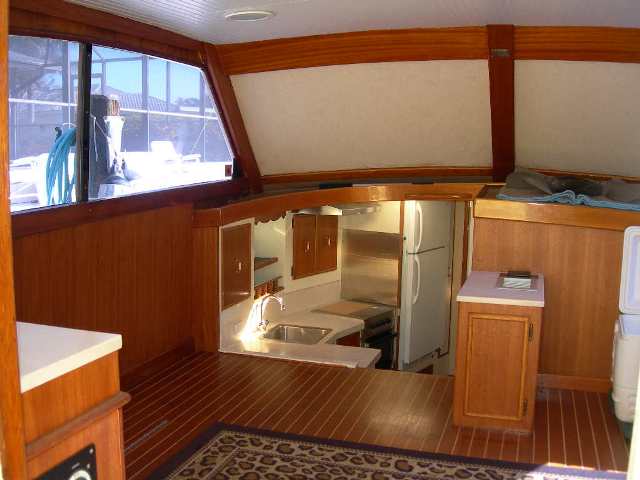

    I like the stainless exhaust hood over the stove. I put in a stainless refrig and would love to match it. Custom replacement?

    No actually it's a typical off-the-shelf Broan you can probably find at Home Depot, Lowe's, etc.
    I wish I had a SS fridge but the white one was brand new and installed just before I bought the boat. Hard to justify changing out a perfectly good new fridge just because it's not SS. I put in the SS panel on the wall between the stove and fridge. Looks nice and adds a measure of fire protection.
