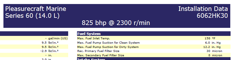

  18. PacBlue
    PacBlue Senior Member
    Jan 9, 2009
    1,995
    Dana Point, Ca
    Here's some info on fuel system data for a S60. Converting in. Hg and your Vacuum measurement of 9 psi seems high, 12.2 in. Hg is 6 psi maximum for a dirty system.
  19. alvareza
    alvareza Senior Member
    Aug 20, 2010
    155
    Scituate MA
    Thank you for this info. I am going to check it again and verify gauge is reading psi.
