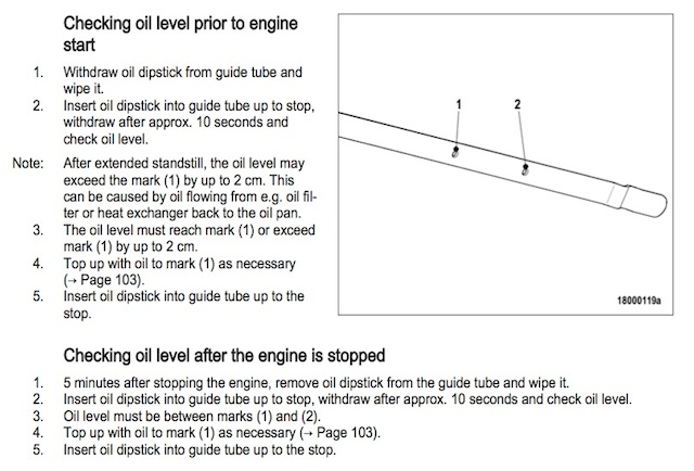

    Hello everyone, the boat on working in is the first I've had with MTU main engines.
    Since joining the skipper has insisted that MTU told him to run the Mains with the oil level at roughly halfway if taking a measurement on the dipstick.
    In theory this won't be damaging the engine but would like to hear other peoples thoughts because I'd rather see the level at full for peace of mind and for good practice.
    Thankyou

    MTU is a brand, not an engine... Diesel Engines Overview: MTU Online
    I checked the 4000-series and they have a dipstick where you should be on the upper level...

    We have a set of MTU 2000 series 16v M94
    Managed to find the manuals and it's recommended that the oil level is between max and minimum so I guess in okay at halfway if that's how the skipper wants them to be run :)
