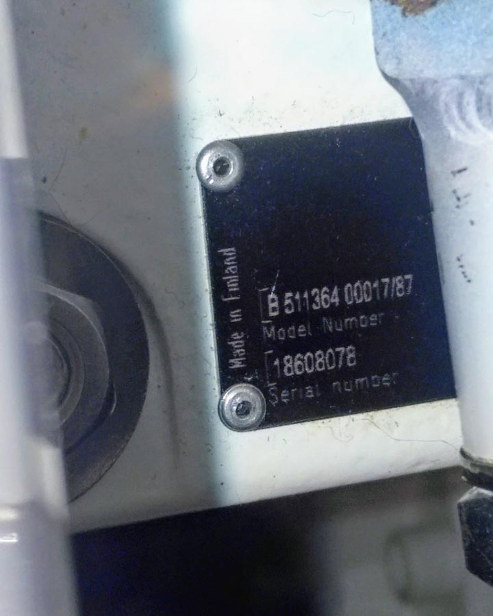

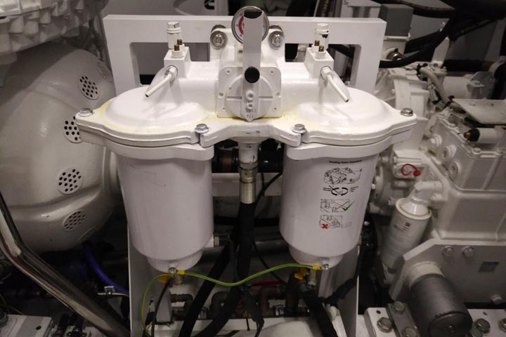

    Can anyone assist in identifying the part number for the fuel filter insert fitted inside these MTU fuel prefilters.
    Thank you.

    For anyone interested, I was able to find the origin of the pre-filter. It is made by Parker and is a model DFBO-10-MA. I do not understand why MTU would remove the Parker label, fix it's own label and brand it as an MTU part. The 10 micron element is also available from Parker, part no. FBO60353.
  3. Capt J
    14,435
    Money!!!!! They sell them through the dealers versus people buying it through a Parker vendor for less money.
