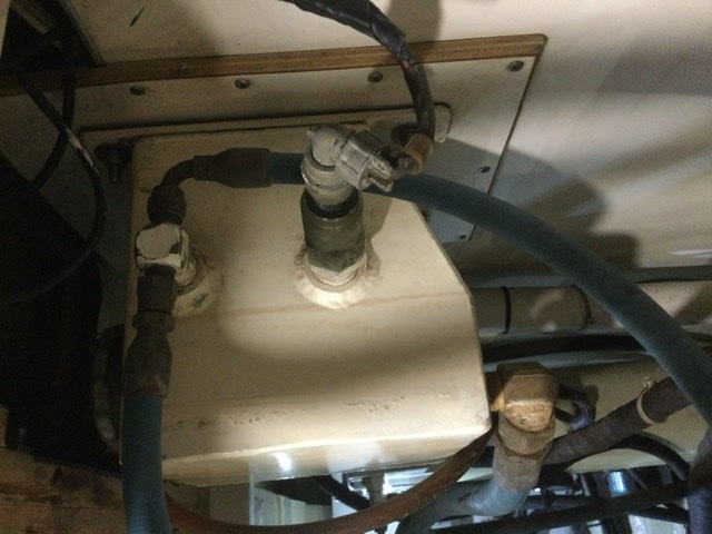

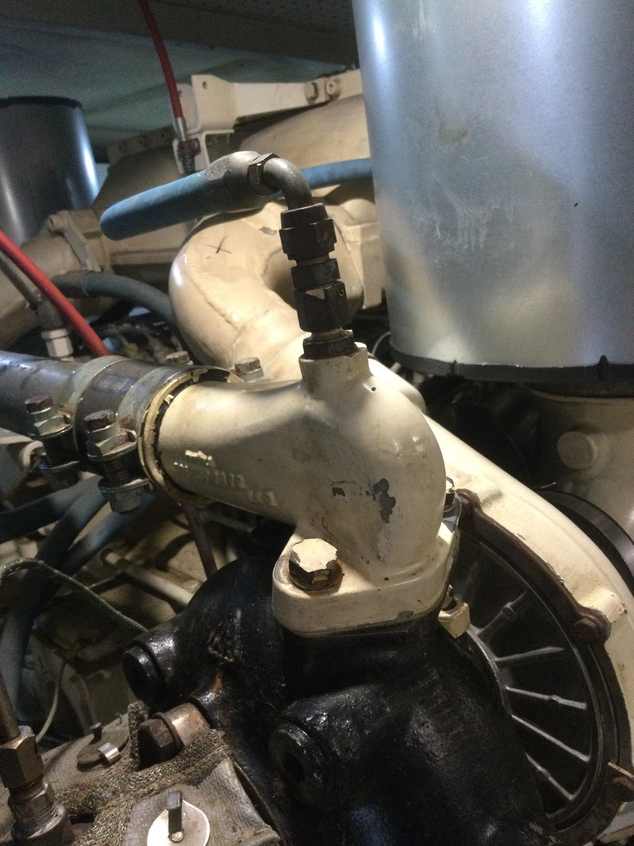

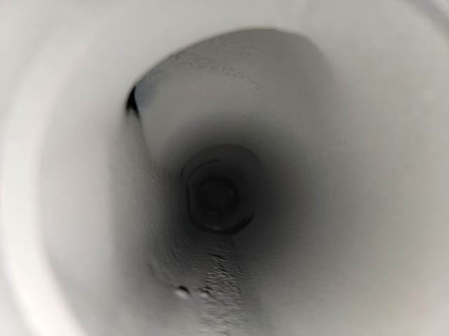

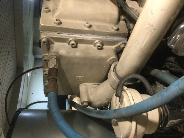

    Found that the coolant lines that go from the turbo and intercooler to the wall mounted coolant tank where completely plugged.
    Unclogged lines and filled and filled the tank and now see good circulation in the tank.
    Could this have caused so much pressure that it could have blew coolant out of the coolant tank and into the plastic over flow tank with so much pressure that the coolant just went straight through the recovery tank and straight into the bilge
    3 hrs into the leg home and engine temps are normal and no coolant in the bilge.
