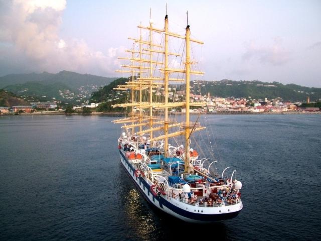

  20. HTMO9
    HTMO9 Senior Member
    Jan 13, 2009
    1,682
    Position of outlets
    There is one more point, where sailors may have a little advantage. On sailboats (especially larger ones) you can lead the generator(s) exhaust and the holding tank vent (without any filter) through the top of the mizzen mast. I know, it would look strange, to lead the exhaust past the tower on a SF but on larger MY, you will see the main engine exhaust to the side below the WL and the generator exhaust(s) through the mast. On the large 5-mast square rigger Royal Clipper even the main engine exhausts (twin Cat 3516) go through the masts.
