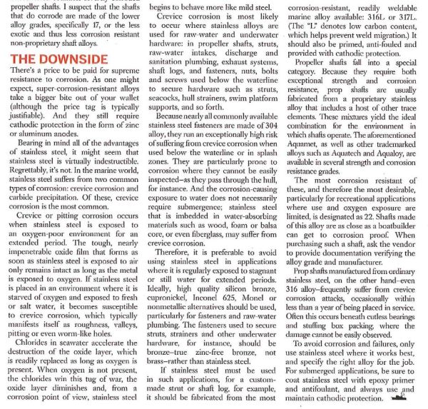

    Yes, this is nothing to do with galvanic action - bonding. Steve D'Antonio had an excellent article on this matter in the September 2013 issue of Passagemaker. Hopefully with no infringement of copyright, I've scanned one page in the image below.

    What it has to do with is proper bedding of the bolts.
