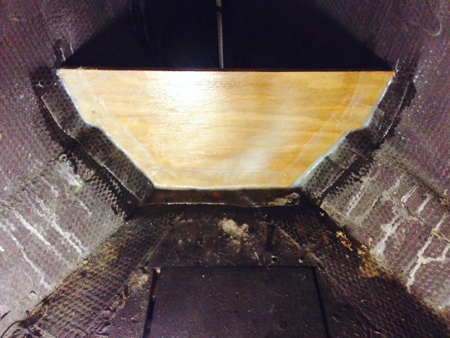

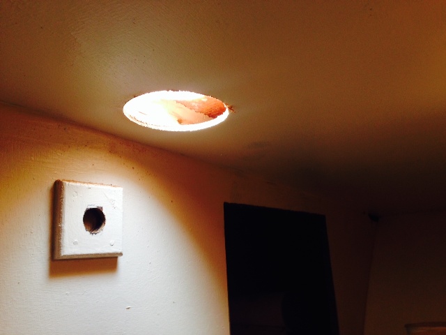

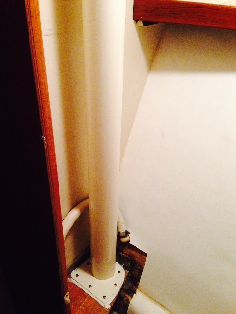

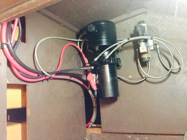

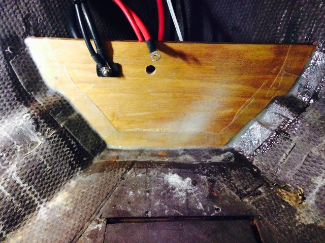

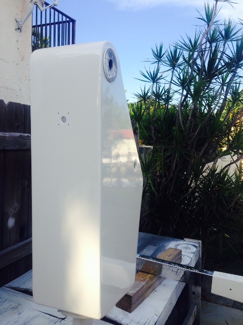

    No finish work complete yet so still pretty untidy :(. But these are a few pics of the work in progress. Bought a used Nick Jackson Mini Hydraulic 1000 and gave it the once over. Glassed in a shelf just above deck level in the port side locker of the master state room. Glassed in a little bulkhead in the forward part of the compartment under the bed in the Master. 4/0 primary cables go from ER to thru bulkhead terminal studs under the bed and distribute current for davit and windlass. Hope to be done next weekend!

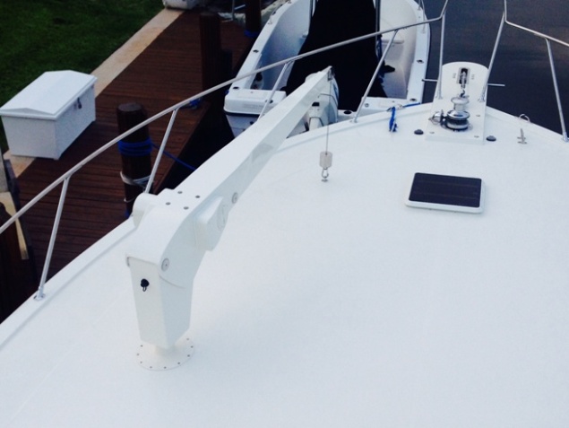

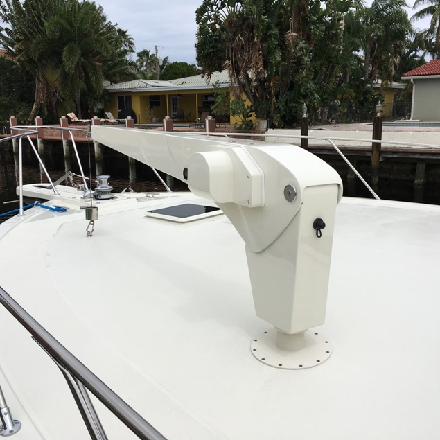

    Looks fantastic! Great work. Does the forward extension move manually or is it tied into the hydraulic system?
  4. Barney Hauf
    Barney Hauf Member
    Apr 20, 2015
    80
    Pompano Beach

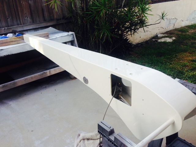

    Thanks!! The extension is polished stainless steel. It moves manually and locks into a couple positions with a pin... The only hydraulic functions are boom up and down. Winch in and out functions are electric.

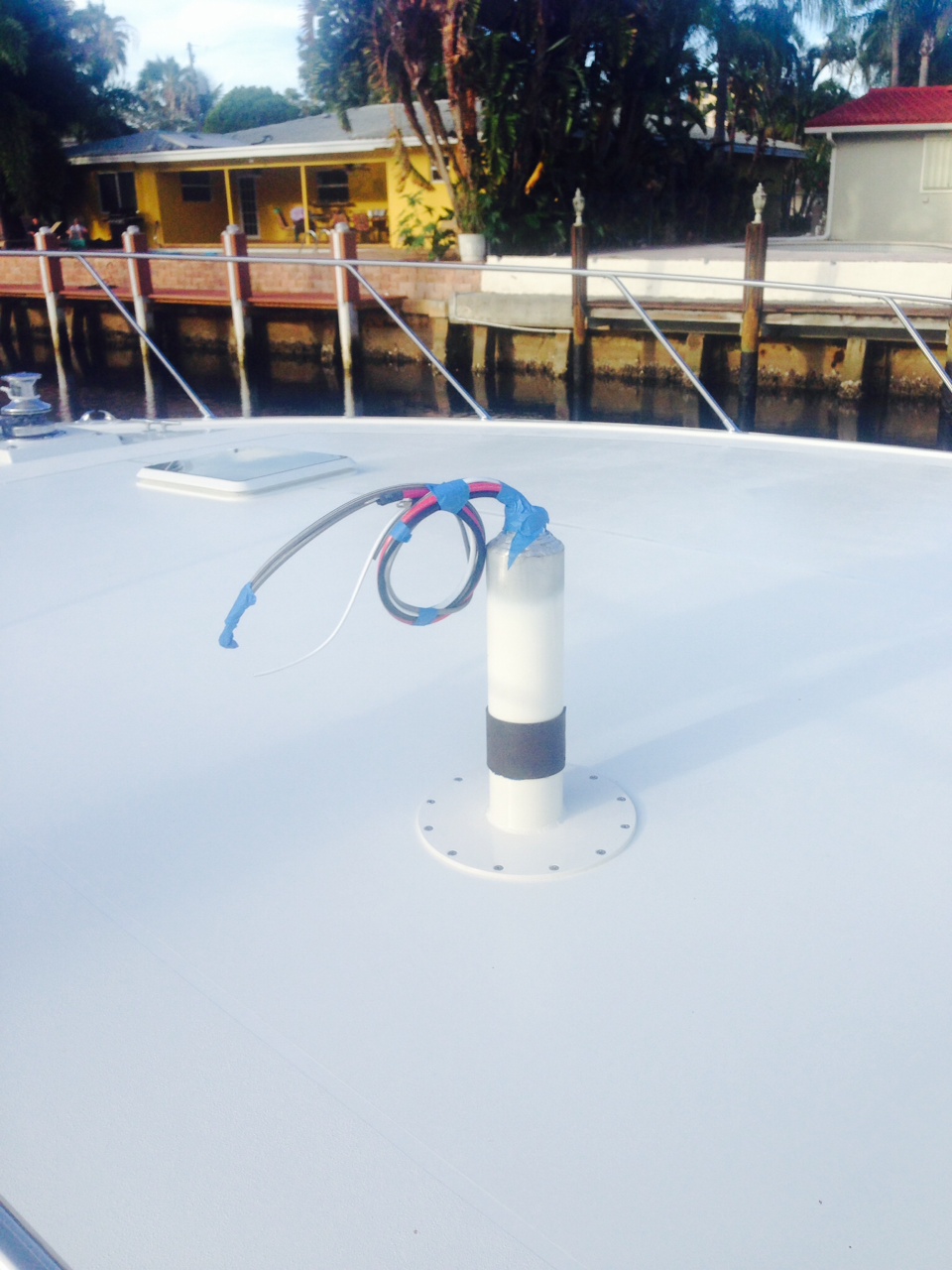

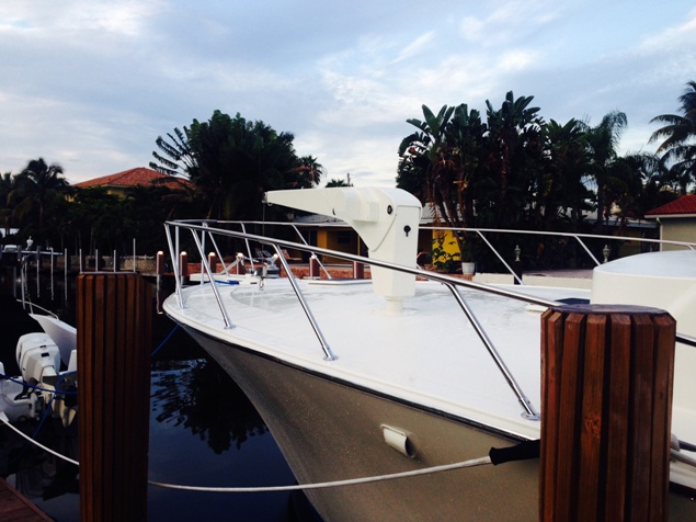

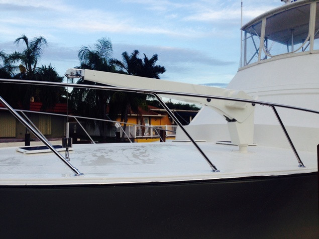

    Done on the foredeck!! Unfortunately I had to cut into my new headliner to thru bolt the hold down for the hook. But I patched the hole in the headliner with a piece of 1/8" door skin covered in the same headliner material and I am the only person it will bother :)

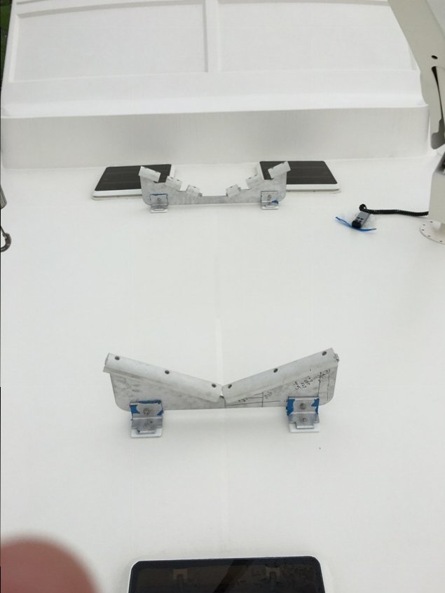

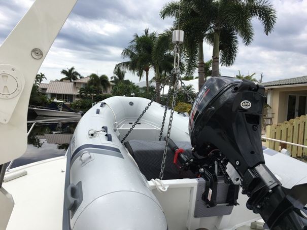

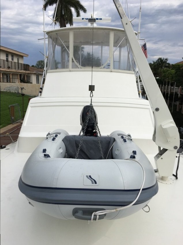

    Finally fitting the chocks for the tender! A Highfield 310 Classic aluminum hull RHIB with a Suzuki 15
    Daniel from Chock Masters in Miami came to template using the set of chocks pictured below equipped with nylon pads on the bottom so the deck didn't get scratched up (I have no affiliation with Chock Masters but great guy and very knowledgeable in my opinion)
    Tender sitting in place to measure the proper angle and placement for the chocks
    Tender looking forward
    Davit standing by and ready for a busy summer!! :)
