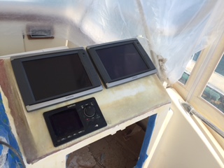

    I have a 88 46 Post I am redoing the bridge console to accommodate newer electronics and I need to match the Gelcoat, where can I source some?

    Not quite complete next steps are blocking and gel coating the surface

    Looks good!!!
