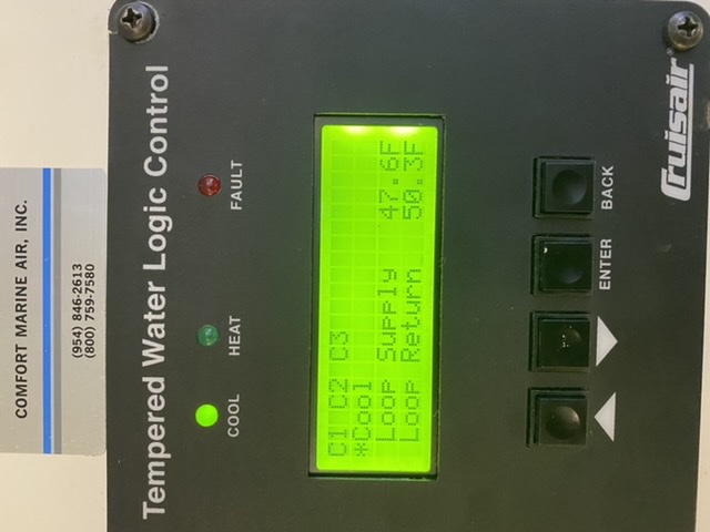

    I'm new to Cruisair ACs. I've to adjust a two chiller system by the 4-button TWLC. No manual available onboard.
    Found nothing on the web...
    For example: how to turn off C1 while C2 is still running or vice versa.
    A PDF or link would be very helpful!

    Are you talking about this ? If so. Press arrow down till you find “Chiller On/off” Arrow on the line indicates its selected. Press enter. Press arrow down or up to select chiller the. Press enter.
    back 3 times to get main menu
    the disabled chiller will be shown as D1 or D2

    Yes that's my unit. And I now understand my mistake. I selected off at the line "Cool" - C1 and C2 together shut off immediately.
    Now I got it, THX for your hint!
    (The display shows for example D1 and C2)
