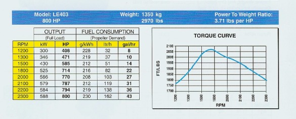

    A fuel burn chart as we all think a fuel burn chart should be, as far as I know, does not exist for those engines.
    The one that PacBlue posted was made by the US MAN distributor, and it's what you can find also on boatdiesel website, but there are some (minor) mistakes in it.
    The following is the official MAN chart for that engine, and while it's the most accurate you can find, it's a bit "German", so to speak.
    In fact, if what you are interested in is how many GPH the engines burn at any given RPM, you can calculate that based on these curves, but it takes a bit of math.
    Regardless, there's a couple of important points to bear in mind:
    You can forget the "full load" curves which are meaningless, except at WOT and 100% load, and the best approximation you can get is by considering the so-called "prop demand curve".
    BUT, that is a purely theoretical curve, because the actual prop demand (which is what drives the engines load, hence the fuel burn) can be significantly different from a boat to another.
    And with mechanical engines, unless you install a fuel flow meter, your only chance to find out the real world fuel burn of your particular boat is through testing.
    [​IMG]

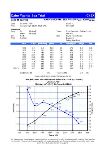

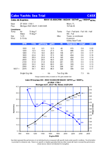

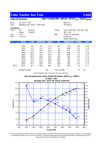

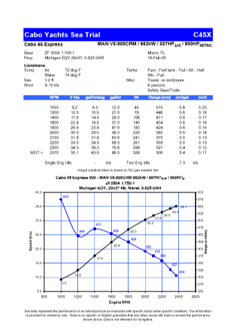

  8. YachtForums
    20,378
    PacBlue hasn't posted since Sept 2020 and he is missed by ALL of us. Hopefully someone else can supply a valid link.
  9. leeky
    leeky Senior Member
    Jan 2, 2011
    381
    Florida
    He hasn't posted since then, but he signed in at 9:07 PM Friday, Sept. 24, 2021. So, at least he's lurking.:D
  10. mapism
    mapism Senior Member
    Aug 9, 2008
    2,116
    Sardinia
    Here it is.
  11. mrcina
    mrcina New Member
    Apr 18, 2021
    Europe
    Great guys!
    I am in the process of buying a Cabo 43 FB with C-12 engines, so this Cabo sea trials will help a lot.
    Thanks again for the quick response.
