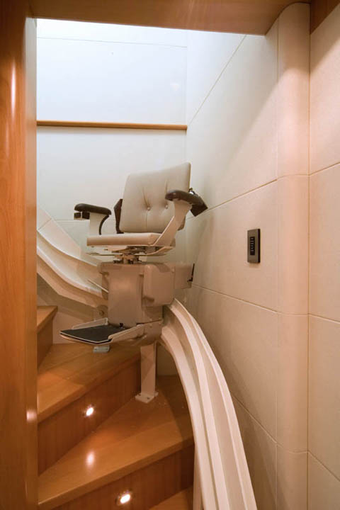

  20. YachtForums
    20,353
    Great post K1W1! Another option might be a stair-lift, like this...?
    [​IMG]
