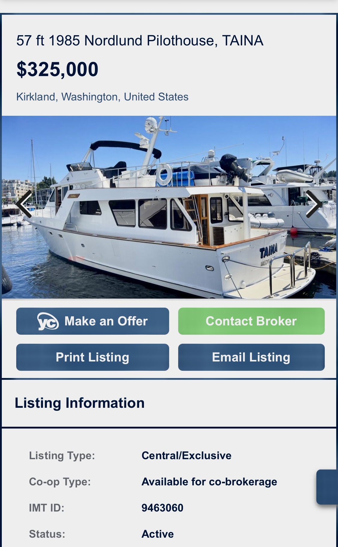

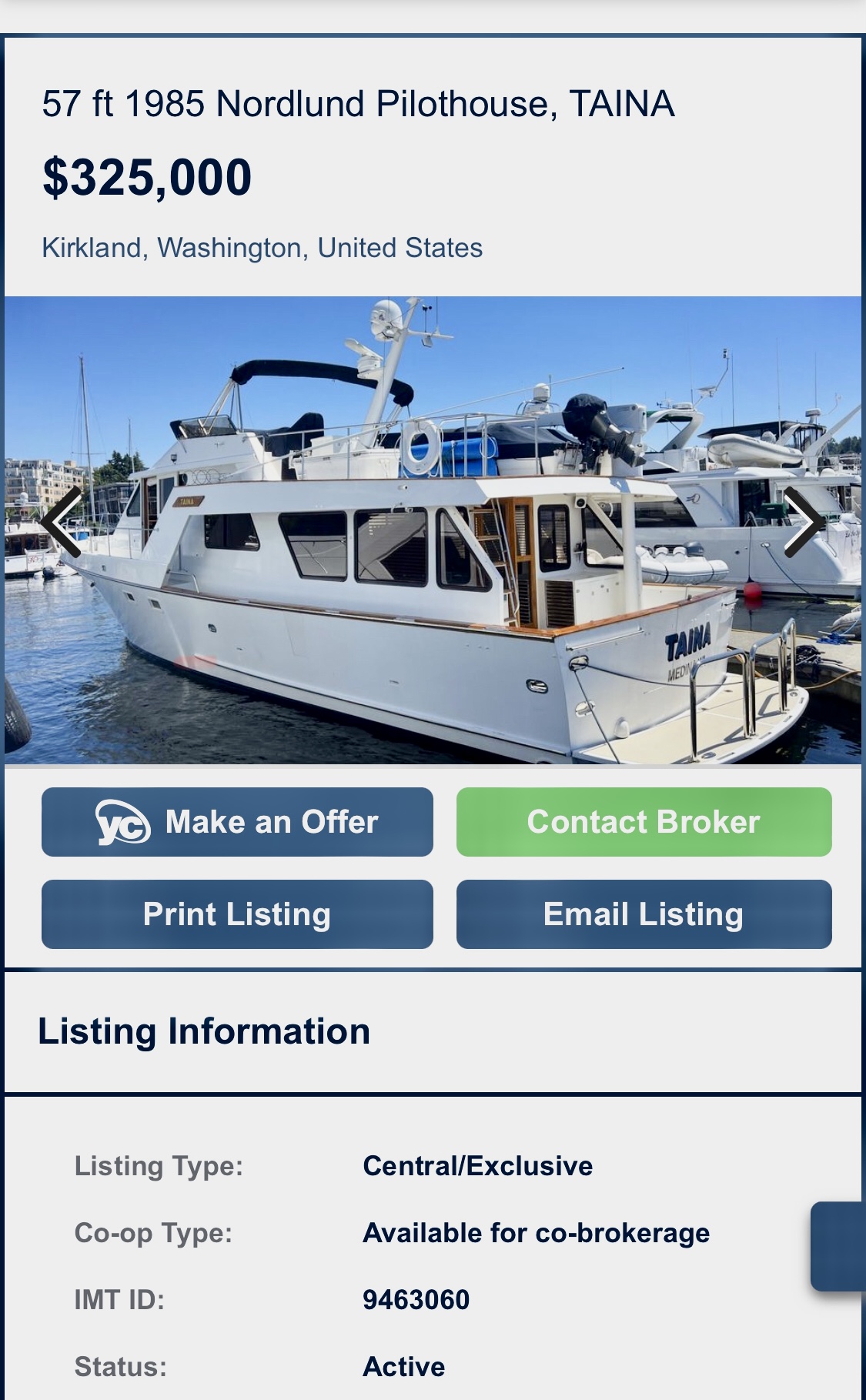

    This might be a good candidate for a DIY buyer. Looks like a lot of boat for the money. 300hp CAT 3208’s should run a long time. Older, but Nordlund is a quality builder. Unfortunately, it’s on the wrong coast.
    I have no connection whatsoever to this listing.

    Great minds think alike. I DM'd this boat yesterday.

    Haha! Ken - You Did! Just getting back to replying. Thats a great boat, I agree! Thats also a very long trip to get it home!

    Not difficult at all to have it shipped to east coast. You can have it loaded on a transport ship in Ensenada and brought around. I know of at least one company that’s makes a regular route stopping in Ensenada and Victoria B.C. as they transit around the world. I believe they stop up in East coast of Canada then down in Florida .

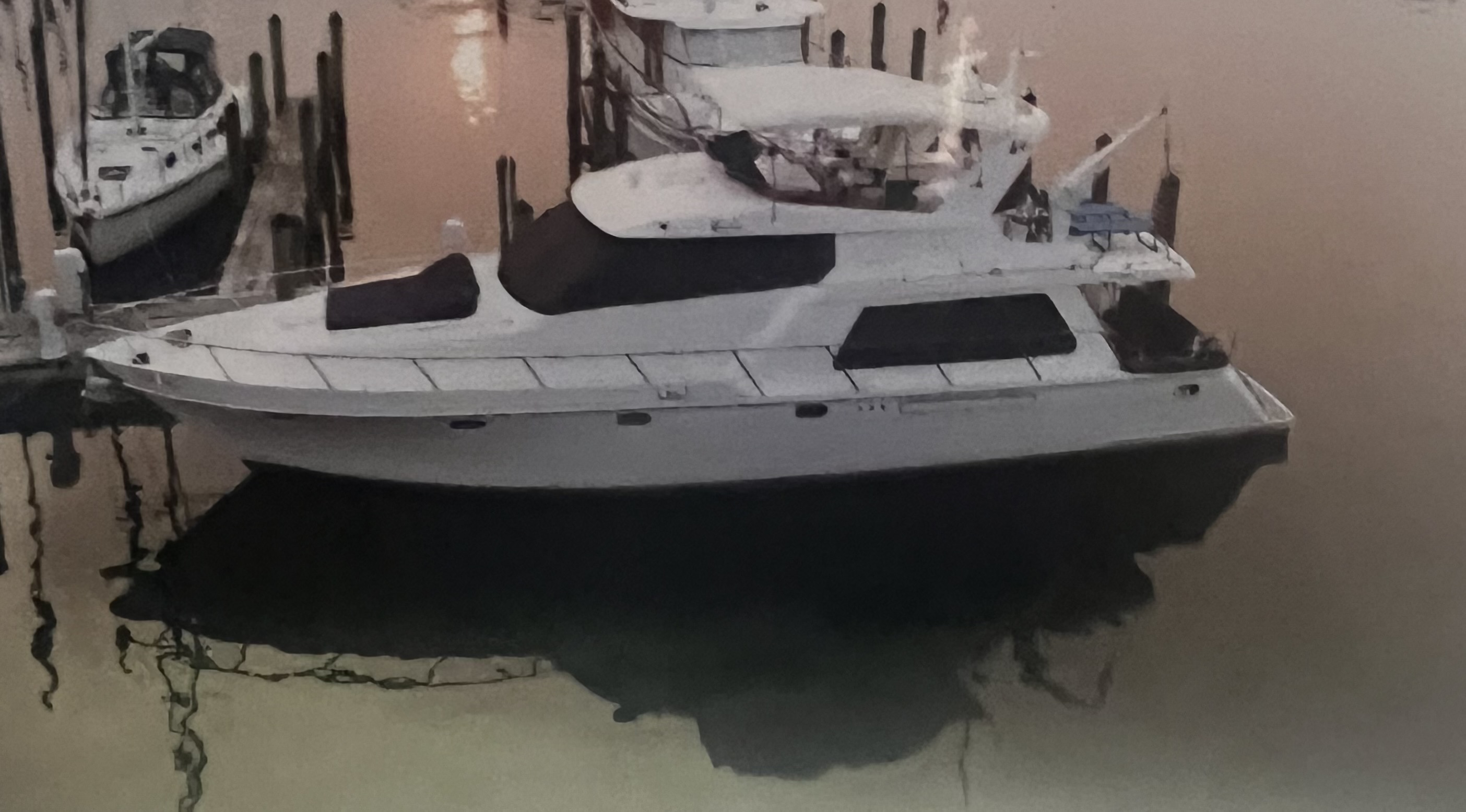

    Good post-You sound like me 7yrs ago.
    My first thought was full displacement trawler thinking fuel economy was top priority; then I realized a semi displacement fit my uses better; I could go slow and get great fuel burn, or go fast (18kts) when I needed to make a bridge opening, out run weather and really jump on good conditions when crossing to Bahamas.
    I wanted 3 staterooms, flybridge, stabilizer, water maker good tender system.
    I’ve logged 7,500NM from Keys/ Bahamas/ east coast ICW / Chesapeake /NYC/ Long Island Sound to Nantucket. After 4 yrs in South Fl, I moved my 54’ Pama to Baltimore Inner Harbor for a few reasons.
    1. After 2021 Hurricane GEICO stopped covering boats over 50’. All new quotes made me be out of Florida June 1-Oct 30. I’d already done the Florida cruising grounds and wanted to see new places. I loved Savannah, Charleston , Beaufort(s). Love the Chesapeake as there is so many places to visit amd plentiful dockage NYC & Long Island Sound are great also
    2. I live in Midwest so Baltimore is an easy nonstop flight /Uber to marina. Although the season is shorter, I could still go south if I want to.
    3. The hassle factor is so much less on the Chesapeake. Dockage is plentiful. Services are there. So many fun towns to visit bs cruising up and down the ICW, or trying to wait for weather wave window to get to Bahamas.
    I’ve also learned that a maintainable boat is the key; I’m really pleased with my engine room, water systems, access to gyro stabilizer. I looked at many boats and was amazed how poorly some are laid out. Trust me, you’ll sleep better getting the “right tool for the job “ than getting saddled with an unmaintainable beast
    Look at the boat, not the brand. I had never heard of the brand Pama, I have a 2007 540Lx, hull #11 and there is a dedicated owners group that 8 of the Hulls are in. The fit finish and layout is fantastic. The live ability is great.
    Budget
    The real lesson I learned in boating is no matter what, the boat you want or accessory or upgrade always costs 1.5-2x more than my original estimate. By the time I had looked at dozens of boats, I understood why some were more expensive and worth the price. You’ll only cry once at the price if you buy the right one …. And “generally” once boats get to their depreciation curve, they tend to hold their value. You won’t make money, but you should get back a good chunk of what you spend if you maintain it properly
    good luck in your search, and don’t settle for something that doesn’t hit all your wishes. IMG_4040.jpeg
