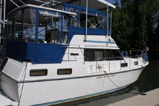

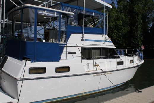

    No, and no. The pic you say is an aft-cabin Carver is an express-cruiser style boat. It probably has an aft-cabin, but more of a bunk you crawl into, not a stateroom with room to change, hang clothes, possibly a stand-up head with shower. An aft-cabin cruiser generally has a flybridge over a salon with above-deck windows. When you go below into the salon, you have good-size windows all around. An express cruiser does not have the salon with large windows, it feels more cave-like when you go below. A big express cruiser has a lot of space down below, but not nearly the space and comfort of a flybridge cruiser. Camper canvas will add a lot of useable space out of the elements, and reduce the amount of boat exposed to the elements. But canvas need to be replaced occasionally, and isn't cheap.
    This is a basic aft-cabin cruiser, the aft deck is raised to give standing room in the stateroom below it. The flybridge is above a standing-room salon with lots of windows. The front deck is high enough for standing room in the forward stateroom. A sport-fish or convertible boat will have the aft deck low for fishing, not much space below it, and a lower forward deck for ease of working lines. This boat looks more like a camper than a working boat, it is optimized for living space.
    The wooden boat you posted...stay far away from wood unless you are very adept at maintaining wooden boats. One of my best friends has spent his professional life restoring and maintaining wooden boats, and his personal boats are fiberglass. You will have enough work just maintaining a glass boat. Which brings me to my first question: what is your skill and experience level with boats? If you are experienced and proficient with fiberglass work, engine work, and/or general boat repairs, and don't mind doing those things, your options open up enormously.
    If you are not well versed in boats and how they are constructed, start learning. Learning by jumping in and making mistakes is tremendously expensive and frustrating. This industry is loaded with dishonest people, and honest but incompetent people. Being informed will save you a ton of expenses and headaches.
    The picture I posted is a Carver, I don't personally love that brand. They are built to be affordable and they accomplish that, by having lower quality. They are basically built like a mid-level RV, which is an expensive and pretty well-built thing. But it is consumer/household-grade fittings in a cheaply made hull. Expect things like refrigerators and toilets and various pumps to fail. I don't expect a new oven or fridge from Lowes to last five years, and a five or ten-year-old Carver will probably be ready for a lot of expensive replacements. You may have to disassemble appliances and cabinets and doorways to replace large items on a boat. Other brands are a small step up, SeaRay and Cruisers and the like, it is a spectrum. When you get into high-end boats you are getting commercial-grade appliances and engines, they are mounted to the boat with better fasteners and methods, usually everything will work with just a cleaning. You can go older on a high-end boat and end up with fewer repairs and a better resale, but for a higher initial outlay.
    Whatever boat you look at, you will get it surveyed, get a very good surveyor or surveyors. Especially with a Carver or similar, they need to go over that hull and structure with a fine-toothed hammer. That will make more sense later. You will want the engines looked at by someone who specializes in engines. Gas engines are easier to find mechanics to evaluate and work on, for diesels make sure they are factory-trained on that specific brand, and have some experience on that specific model. Don't run away just because the engines or boat need some repairs, maybe better to have a freshly repaired engine than a tired one or unknown.
