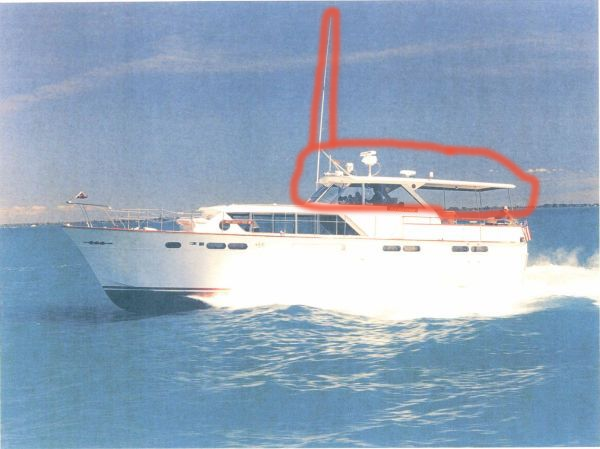

    Below is a photo of a similar Constellation, with the bridge circled in red. This would be the only part that needs to be removed, correct?

    Somebody is going to dismantle 55 year old windows and frames?
    Angled supports? Overhead lights , radar signal cables, nav lights, TV antenna coax, GPS coax, wires (air hose) to the horns, any other overhead electronics, Windshield wipers, defoggers, stereo speakers, extra vertical supports, trim and paint lines at assembly joints? There is enough to make work for several days on each end if it all dissembles easy.
    NYCAP may have been concerned with extra items that would be involved in a complete flying bridge including redundant electric wire harness and switches, steering, throttles and clutches.
    This pic does not have the fly bridge, but does still have many hours of properly dissemble and re-assembly, even with no deteriorated hardware.
