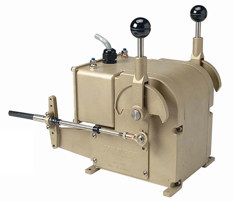

    One question: is the gear selector on your gearboxes controlled by a lever connected to the Kobelt actuator via mechanical cable, or is it only wired up?
    I am asking because one of the reasons why I prefer Kobelt controls to most others is that their gearbox actuators (and also the engine governor ones, when mated to mechanically controlled engines) still allow to operate the g/box selector by hand with the actuator levers, even in the event of a catastrophic problem disabling all onboard electronics.
    But this only applies to gearboxes with mechanical selector.

    Mine have a gear selector box on the port engine and that goes to each transmission they are actually shifted mechanically by this gear box — the box gets an electronic signal from the kobelt or the yacht controller and moves the levers via some type of actuator . There is a wire that goes to the ECU and it has a breaker in the engine room panel — i have a power breaker to each engine P & S and one for the Kobelt ECU so three breakers.

    I'm struggling a bit with your description, but I think you've got mechanically controlled gearboxes, driven by a Kobelt actuator (the component that you are calling "gear selector box") which is connected via push/pull cables to the actual gear selector levers, which are necessarily on the gearboxes.
    The fact that it's placed on port engine is irrelevant, because this actuator handles two push/pull cables, so regardless of where the actuator is placed, one cable goes to port g/box and the other to stbd.
    If this photo reminds you of what you described as "gear selector box", that's the Kobelt actuator which works as I'm saying.
    And which allows you to select the gears also manually with the two black knob levers, after disengaging the electrical motor.
    So, in an emergency, you can still operate the gearboxes manually - though of course that's challenging, if this actuator is inside the e/r...

    Thats exactly what i have — gotcha on the remote
