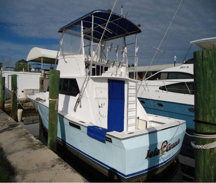

    Anyone got any info on the Viking 33 they can share? This is a boat that has had a lot of work and money put into it by the previous owner. I purchased it recently. I know it has 2 new aluminum tanks and aluminum hard top canvas and the interior was gutted and reconstruction was started. The motors might be seized so today I removed the spark plugs and sprayed each plug hole, i will repeat this step one more time in 3 days before trying to turn the motor. The boat has new paint top and sides. I have never owned one of this size so any input would be helpful.
    There was water that came out one spark plug hole on one motor all the other plugs were dry. The other motor was dry completely. I think one has a blown head gasket (hence the water in one plug). The transmission looks good on both sides. I think there might be a hydrolock on one cylinder with the water in it ( I am guessing) which might be the cause for a lockup. There is a water line that reached the bottom end of the motors but no water was present other than that one plug. The oil in the dip stick was grey on one with water and the other was pretty much blueish.
    I think i got a good buy. She's a pretty boat and I hope to get her running soon. Any idea as to the costs that went into the parts and paint that were put into it?

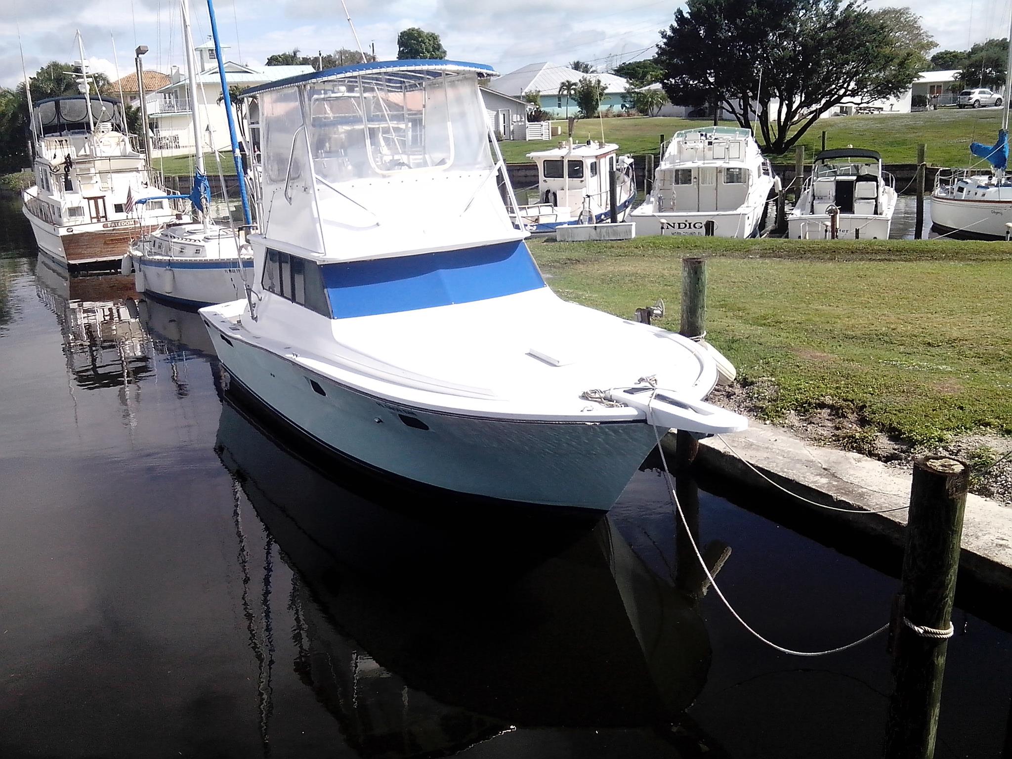

    How Nae Nae happened upon this thread we will never know... She was trying to find pictures of '73 - 33' Viking and the forum popped up...
    We are now the owners of the '73 - 33' Viking...
    It has been through two more owners with repairs started but far from completed...
    It has survived a major storm and a category 5 Hurricane with minor damage...
    We purchased it knowing full well it will have to be gutted and rebuilt with 'New engines' and interior, including wiring and plumbing & all cables etc...
    This by far is the most extensive rebuild I have taken on, and i know it will take a year or more before completion...

    I decided to replace the flooring and found the stringers were not in 'Good' shape as I was told... should have seen that coming. So I have currently removed the stringers from the front to the bulkhead and am preparing to replace that section first, just about ready to go back. Weather here has been rough lately and hoping for a break soon...
    Also have the port engine removed (looks like a car engine had been used) and will remove the starboard engine soon.
    I have found multiple leaks that have to be repaired before continuing with any other repairs, due to thieves taking equipment and leaving holes to damage from two storm and last years hurricane, although the damage doesn't look bad at all, during heavy rainfall the water is coming in steadily. (due to unforeseen circumstances, i wasn't able to get down to there to work on it for almost a 8 weeks... I have an automatic bilge pump set in the lowest point to keep the boat drained...guess what quit... found almost 2 feet of water in her hull... thank goodness someone called and to say that I should go and ck on it because rains had almost sunk two other boats and the Viking didn't look like it was sitting right... bilge was only 3 mths old...)
