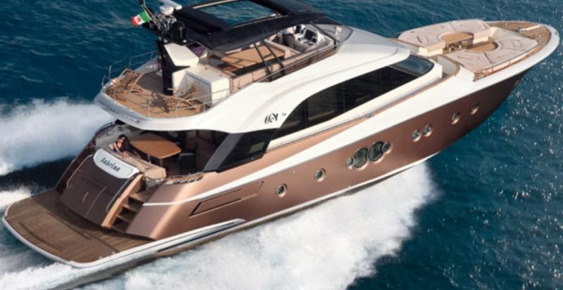

    Opening the April issue of PMY, thankfully free..., page 16 is a picture and drooling praise for the new Monte Carlo 70
    Whoever designed that thing should be forced to cruise on it for a year as it has no bow rails whatsoever! Forget using that fancy sunpad underway and even on the hook you d better not fall asleep and roll overboard
    Then we have that raised foredeck again with no rail so good luck tending to bow lines... You can't stand there except in calm conditions to reach the chocks..
    Stupid!!
    And then when you are tied along side a fixed dock, you can't board the **** thing as there is no boarding gate...

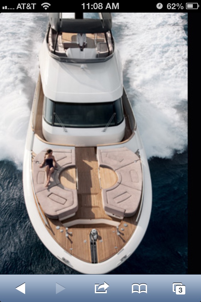

  2. Pascal
    8,120
    Here is the side view...

    There is a grab rail along the bow the length of the cushions. I have mixed emotions. They've made LOTS of sportfish with no bow rails and those guys don't have problems with tending lines or setting out an anchor in a sea. I've worked as a mate on a few many years ago, and never had a close call. I also don't think anyone is going to be on the bow of any yacht that size in anything over 2-4' seas at cruise because they're going to get soaked anyways from spray..... I do agree the boat is a little too much form over function.

    There is indeed a grab rail around the pad but it is level with the pad, it s nearly useless.
    I know it s been a trend with big SF but only the crew goes forward. A MY is different. I see it almost everytime we go out, whether on charter or even on my own boat... Folks like to sit or lay down at the bow when cruising is calm waters. There is no way I would allow anyone forward on a boat like that as soon as the engines are running. Next thing you know, they ll do titanic picture, without any rail to hang on

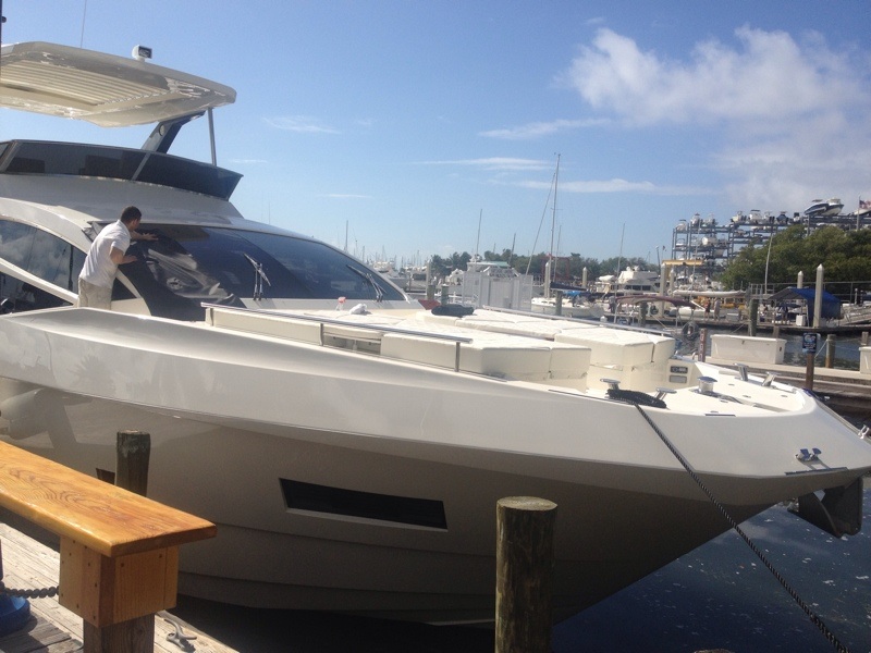

  16. YachtForums
    20,353
    I was onboard the boat at the Miami Boat Show in February. Tom Serio was with me and he took a few details shots for me. I know he sea trialed the boat and wrote a review for one of the rags, but I wasn't as optimistic. There were some blatant fit & finish issues that made me question the areas I couldn't see, however this was the first build in the series.

  18. Capt J
    14,432
    I saw the boat yesterday leaving the show and was behind it coming in Port Everglades and passed it. The sunpad cushions are above that little grab rail on the outsides. It is truely a nuts idea.....Maybe they strap you in like on a stretcher when you're up there???

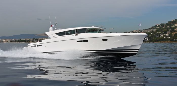

  19. Pascal
    8,120
    Here is a pic of the Astondoa 72. Same stupid design...
    And note how there are no rubrails...so what are you supposed to do when coming in a narrow slip with pilings on each side? Have 2 crew on each side manning fenders?
    I don't understand how European builders keep ignoring the needs of the US market yet want to sell boats here...
