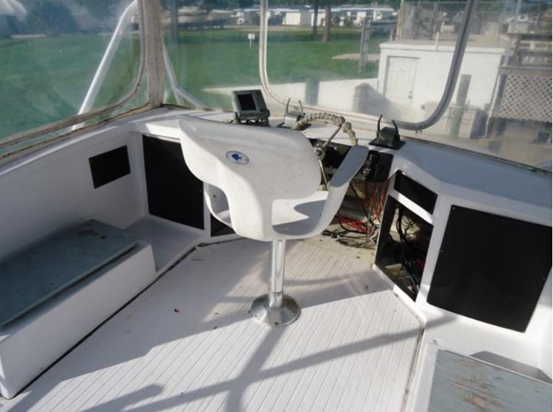

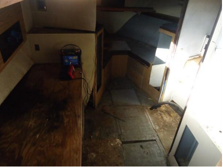

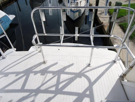

    The inside is gutted but has wooden construction that's been started. However, it is missing the fridge, counter tops, drawers, cabin seat/cushing and pretty much everything interior wise. If anyone can point me in the right direction as to where I can find these interior parts and also flybridge cushings stuff and outside parts I would appreciate it.
    Here are some pics so see what exactly is needed.

    Regarding the interior, and fit-and-finish, most probably you will have to fabricate all that as stated by NEO56, if the layout is in its original form, you might be lucky in finding secondhand cushions and such advertised for on the Internet, for now, I see you can do with anything you may even find in a thrift shop, not even marine grade, put them out when you need them, store them in when not in use. Yes it is a hassle, but until you have running engines, operating electronics, tanks, wiring, hoses, etc. etc. everything else is merely cosmetic.
    What you have in your hands is called a "project boat", so you should start from the very beginning with us here, no one has the right now to tell you that you made a wrong decision, we can't tell, and since you paid for it, it is yours and we can only help you get your experience better from now on. So, tell us, did you get it out of the water and checked the bottom and the running gear? Did you check the tanks and hoses? Did you check the batteries, panels and wiring? Did you check the bilge and thru-hull fittings? Having the interior gutted is a vantage point for you, you have more access to things otherwise you'd be taking the boat apart to find. Fill us up on the case and you will find many around here that have a lot to give forward ad assist with.
    Now, back to the interior, measure everything for reference, you can even make your own templates using cardboard, I can tell you more about this if you want. Then you can start a thread for lets say galley fitting to ask about materials and finishes, another for lighting, what will give your the best lighting for the least power draw. You will also be told what you can do on your own, and where you need a professional to do for you, especially when the matter can pose hazards or inflict damage or injuries. To me, a project boat is lots of fun, and I might be admitting this for the first time here, I have "few" project boats in store, some I did work on, and all I didn't have time in past to work on or complete.
    For the fridge, again, check the cutout opening, know what electrical you have ready there, 12vDC or 120v AC, then shop around the Internet for new or used. The counter top can be as easy as an MDF board cut to size and fitted then coated with special material that would imitate any stone you want, (search for counter top refinish here on the forums and you will find lots of good info), or can be any wood backing with tile, stone, wood, stainless, corian, etc. The good thing is you can modify few things at this stage, and this is a good advantage. For drawers, make a cardboard template, choose the slides, then solid wood, veneers, painted MDF, etc. you can build scrap wood from your template to check for fit and finish, then take it to a cabinet maker with your chosen material and have it built, that is if you couldn't find something ready from another donor boat. Again, finish what is important because you can't cut so much cost, these stuff you can easily play with to your advantage, and when you have a financial limitation for certain things, be sure to mention that, is not an issue and you will get the best advise there is from everyone around here, don't doubt that.

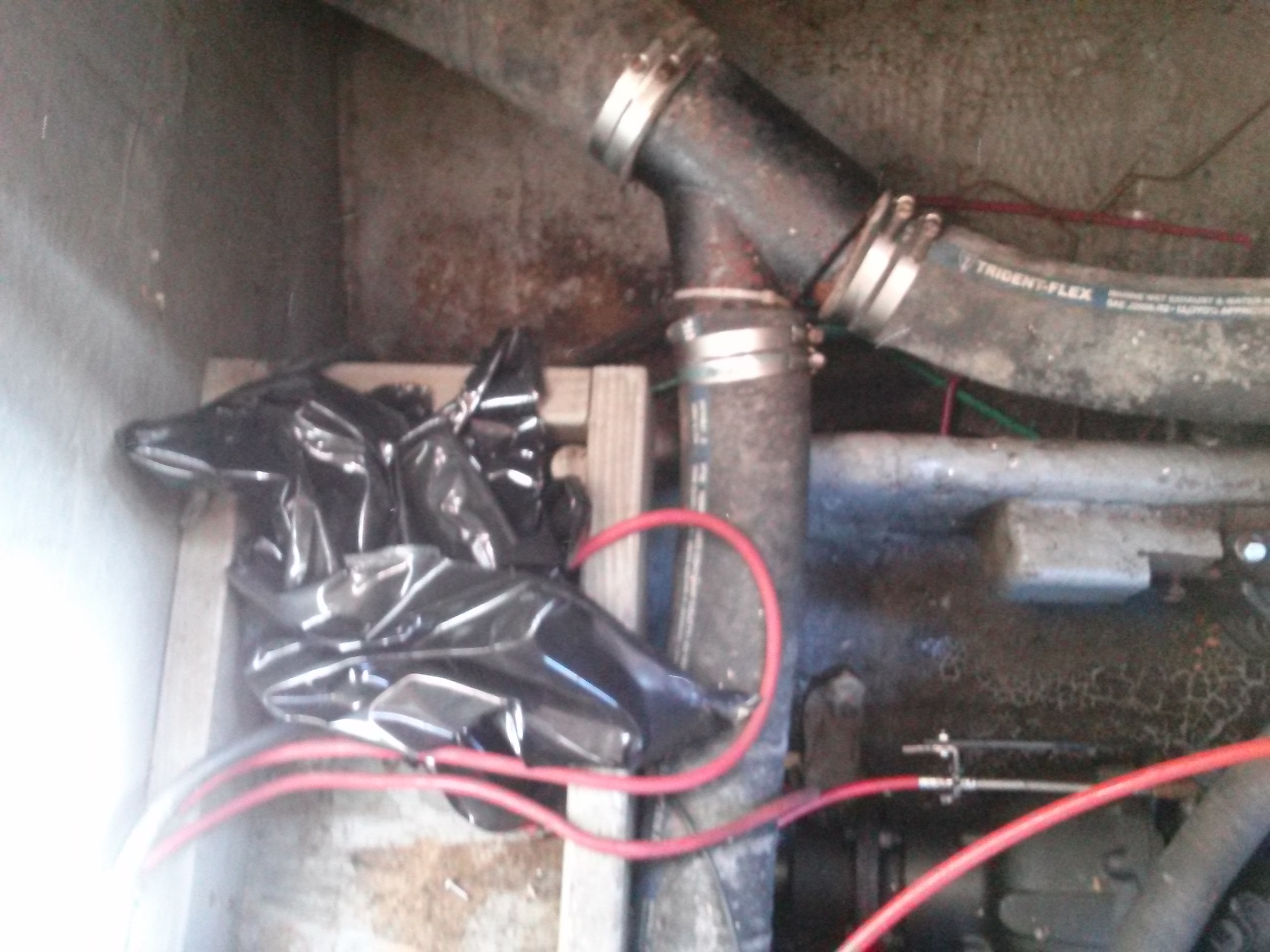

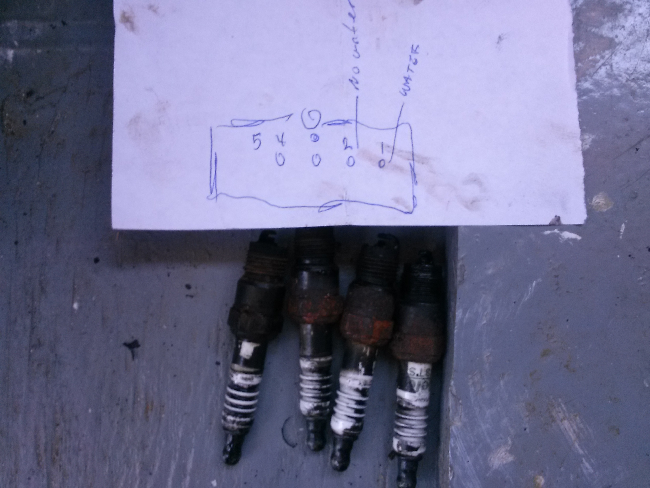

    Neo yes I agree, the motors is where I started. The interior is basically last on my to do list and no I did my own survey based on my knowledge of boats I have owned, I have owned 3 in the past and still have the 3rd one apart from the Viking. In those past boats I have rewired and replaced thru fittings and so much more so i think I'm doing ok so far. I have done very well in the past picking out boats with good motors to match. I have been fortunate to have been able to enjoy each boat for a few years put a little money into them and sell them for a profit. I have to say it was a little intimidating to get into a larger boat especially a yacht this year. however the interior was gutted and there was nothing to I coudnt survey myself. I did take pictures and look at the tanks which are new like as i mentioned (photos added), the hoses are flexible too and not stiff and dried out. The bilges are working and the thru fittings as I did run the bilges to be sure it was operable. Since everything is exposed I was able to get a good look around. I did get my hands dirty and inspect and did the required research and had a mechanic on the phone giving me some pointers as to what to look for mechanical wise.
    The best part of owning a boat is working on it and enjoying it afterwards i find this very rewarding as with most YF goers, atleast in my book thats how I enjoy myself. I can see myself at the boat slip with operable motors giving her a buff and slowly bring her interior back and adding a flat screen a fold out sofa and PS3 for my kids to enjoy. I hope to have this beaut visit Bimini or further one day just a few times and I will have reached my goal. Mostly she'll be my serious offshore fisher in Miami and Fort Lauderdale and something my kids can enjoy with me, they love the water.
    All boats are money pits:
    I have to disagree with you here Neo. I havent found that to be true though I have heard horror stories but these are people who dont have a thumb for boats or havent done the proper research before purchasing, I have spent on each one so far nothing in the thousands or even a thousand! I visit the boat fleamarkets and shows when they come around and shop there. I would describe it as an investment rather than money pit, this is just how i view it. Basically, I have a 4 year old boy and a 8 year old girl (girl high functioning Autistic) and have been showing them what life on the water is about the fishing, swimming and so forth. So it's basically a way a life I am instilling into my kids as my dad did with me.
    Thank you for you input Neo.

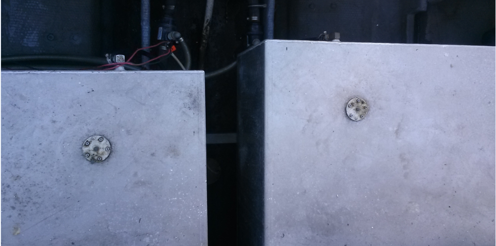

    Anyone know what size gallon tanks these are?

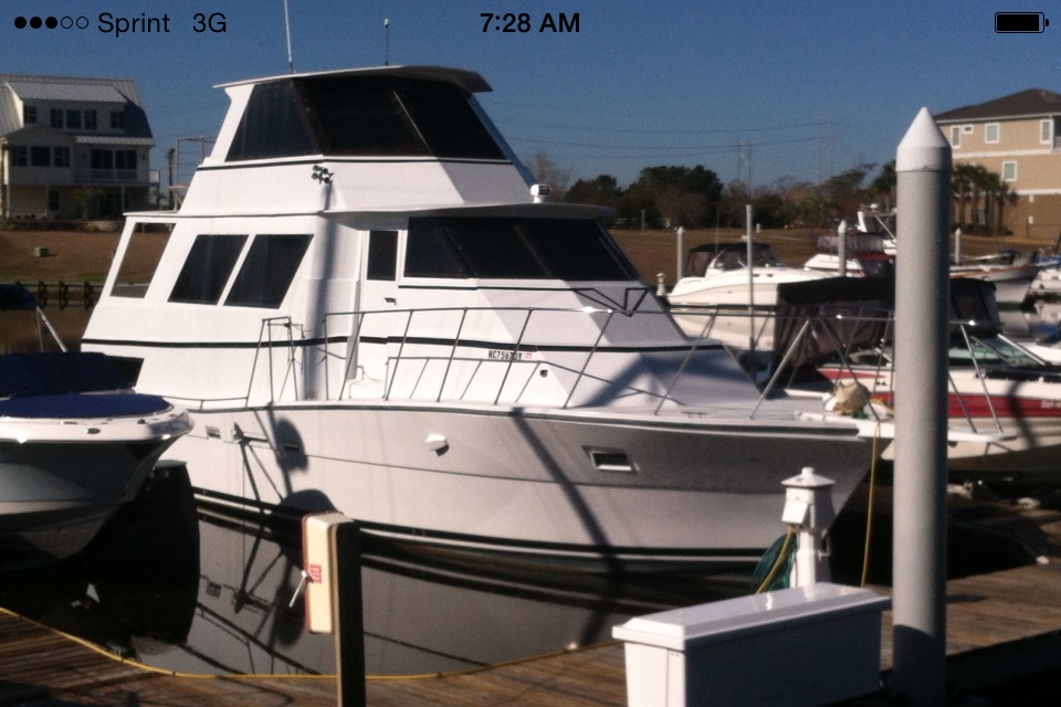

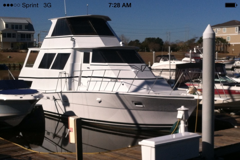

    image.jpg Here is an exterior shot, she's a 1 of a kind the previous owner started from the hull up with a reconfiguration, very unique. He died in the process & now the interior needs to be completed. I will send interior pics next week.

    That's a nice one you got there, kinda reminds me of what i got going on with mine. This week i tow the Viking out of the sellers marina to another marina where she'll stay put until i can do some work on the motors. I will be towing her with a 22ft, i need to check weather and current conditions. I can easily lose control of her not to mention the insurance I need to add. All new to me.
