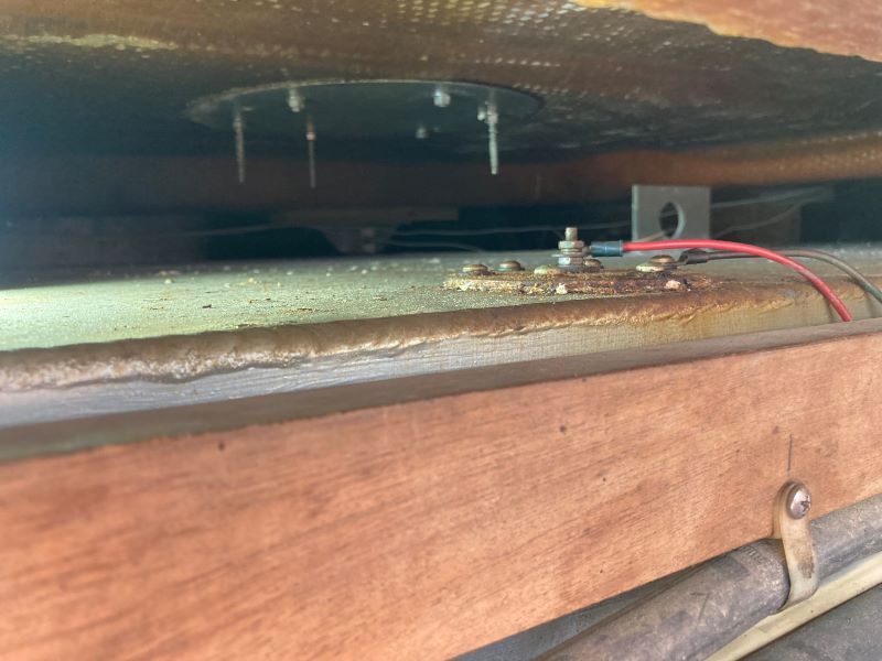

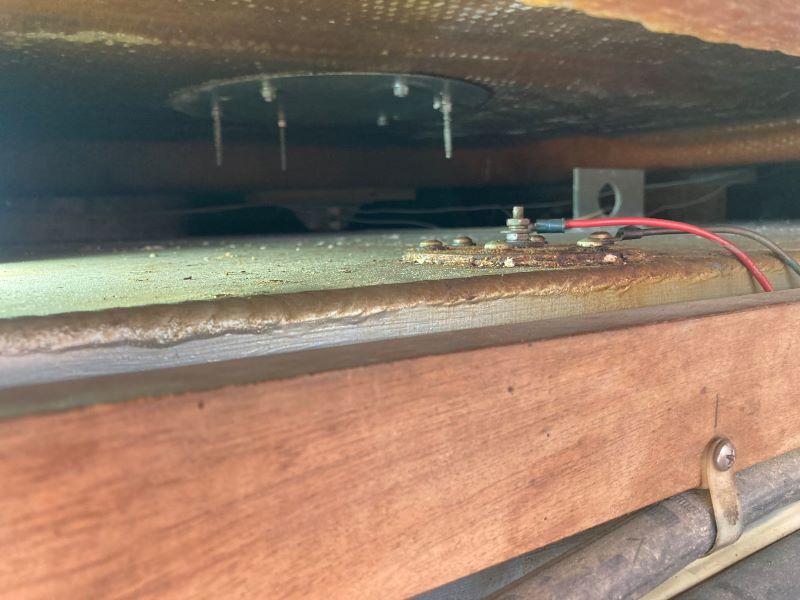

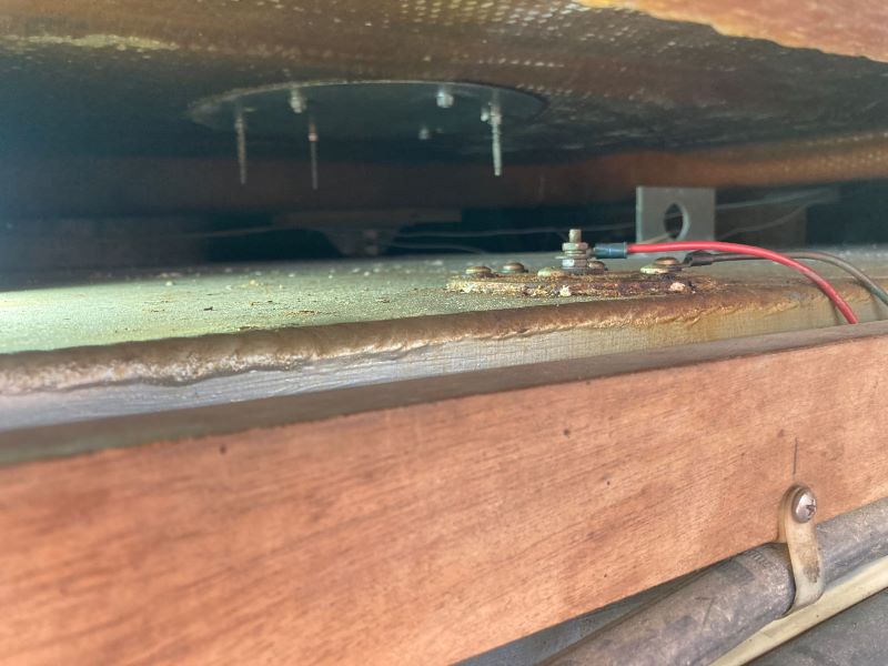

    Our 43 had a fighting chair. There is a thicker core in the area of the chair mount, but it has an external backing plate. You can see it in the photo.

    Mine looks just like Gregs. 5" between the tank and sole, 350 gal tank.
