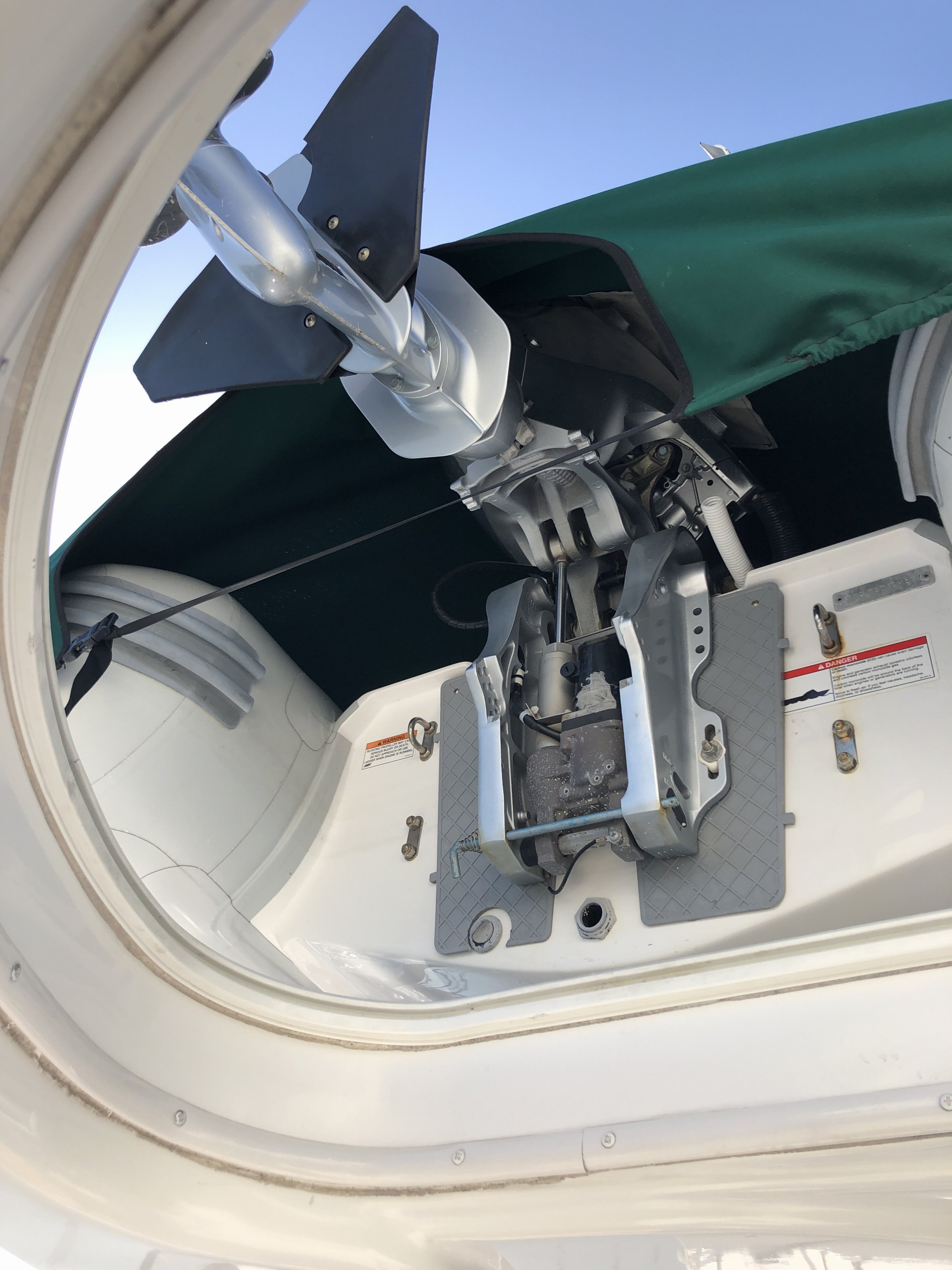

    My 2000 Voyager came with an older zodiac. It is stored on the upper deck and is lifted with a crane rated for 600 lbs.
    I want to purchase a newer inflatable, considering the AB brand AB10VS DLX
    Over all size is very close to my current zodiac but it is heavier due to the interior fixtures.
    So any concerns storing boat on flybridge? Can’t find a weight limitation in my old paperwork
    Thanks for help

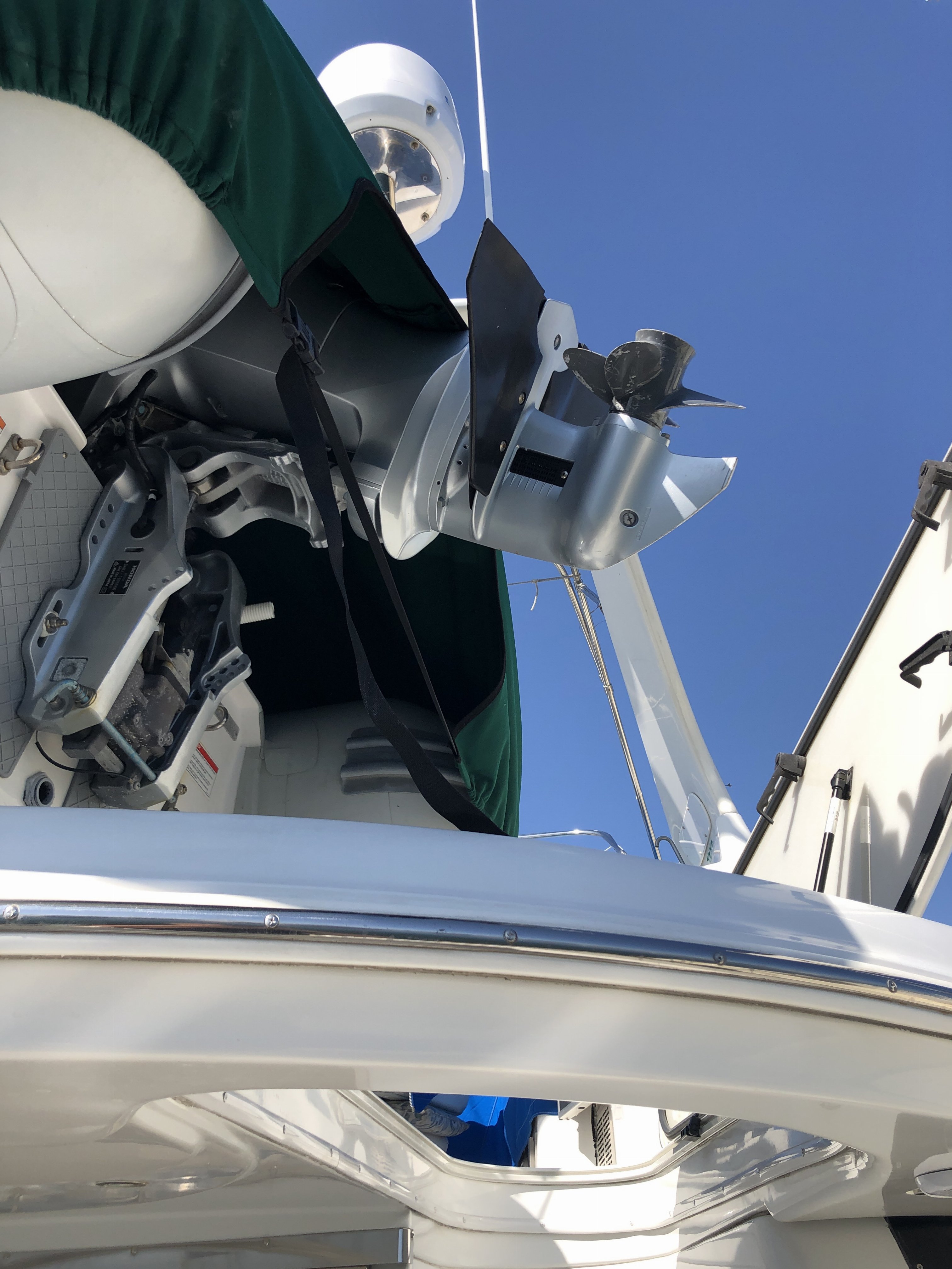

    The Zodiac 310 was right at 10ft if I remember right. I had a 6 hp Tahatsu outboard. The prop rest nicely on a wooden block which just allowed hatch to be closed. However rarely did we close it
    I have replaced it with a AB model slightly longer with a 20 hp Honda. Now the prop extends over the hatch along with the end of the tubes. But it does not impact access up the hatch. I am under 5’9” and have plenty of clearance. If over 6ft a little ducking might be in order
    It is supported by 4 Stanchions that are removable and adjustable
    We do not use the hatch much so it was an easy choice to go with the bigger inflatable. In fact I’m probably going to remove it completely

    Here are a couple of photos of boat in stored position

    Never figured out how to resize photos on this site. Pm me and I will email them to you direct
