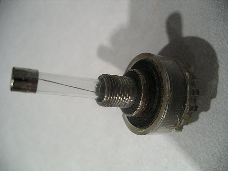

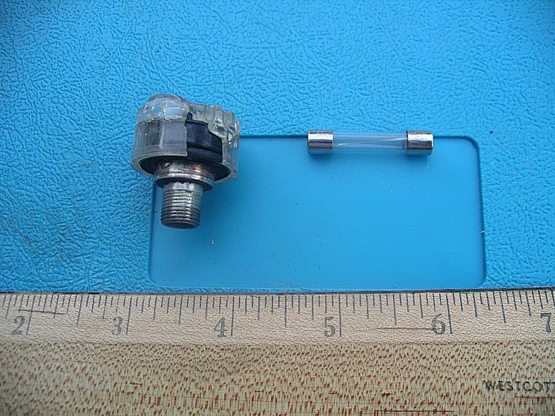

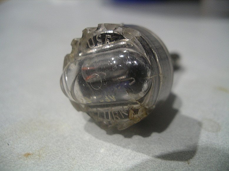

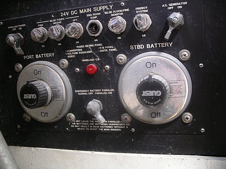

    A seller of similar wrote these have a 25,000 hr. rated neon lamp and that their supposed to light when the fuse is blown. I would like to purchase one for a spare but so far not found a source so maybe another Bertram owner?? In my 46' they're in the 24 v. engine room panel.

    No cigar on any. Found a similar one on Ebay but seller said the neon cap light would not light on 24 volts so I suspect Bertram used the wrong ones which explains why when I removed a fuse from one the cap never lit up. Found some small 24 v. LED indicator lights on Amazon so may wind up replacing the glass cap holders with regular plastic cap holders and adding an LED at each to indicate fuse is good but project not top of current list.
