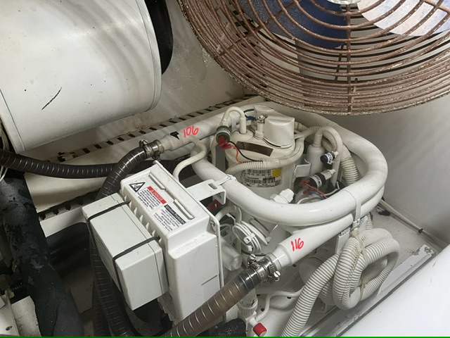

    Thanks for responding. I flushed by taking the hoses off and I have a garden hose adaptor that I spray through the unit. The readings are in the picture. Once again thanks for the help.

    Top of compressor is hot. Infrared gun says 172.
    Big salon unit is 146 and 113 on the heat exchangers.
    If you move the IR gun around a bit on the unit in question you can get 132 and 116.

    Please look at that picture above, where you labeled 106. Is that an outflow label with water flowing out?
