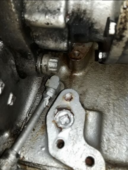

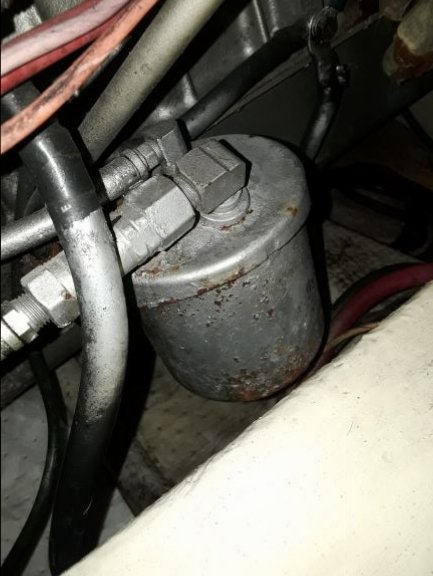

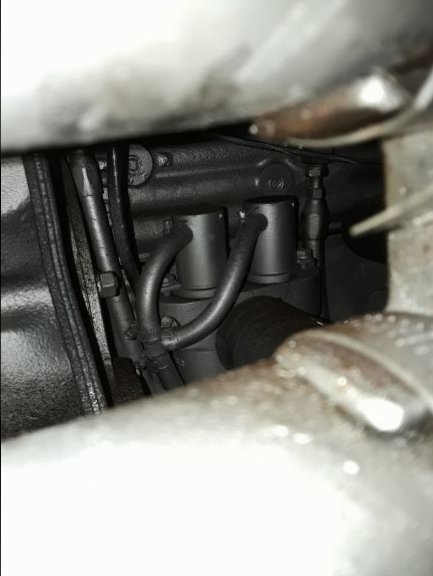

    I have J&T 671, 485 HP engines in my 1987 Ocean 44. Help me identify this engine component. The canister is located on the inboard side, it has 2 hoses, the larger one goes to the crankcase, pictured and the smaller one goes to the blower bypass valves. My guess is that it is a breather for the crankcase and the bypass valves.
    While I'm at it, how do you know the by-pass valves open and what boost pressure do they start to open?
    All help is greatly appreciated,

    I believe you're correct on the breather identification... I think the newer models had the breather moved to the valve covers...

    I'm convinced it is a breather, I took it apart, small amount of puckey oil inside and and a wire mesh filter in the can. Also has a petcock on the bottom for draining. Thanks for the help.

    That is also a fancy check valve on it. It will flow away from the air box at very low air pressure.
    Designed to let oil drain from the air box at idle. When pressure builds up, that check valve will close keeping pressure from building up in the crank case. Also keeping any pressure for top end boost.
    The screen is to capture sludge and and grime that gets blown into the air box and not drain back into the sump with the oil.
    The return tap on the blower may just be an easy access point for return oil.
    Later versions of this looked like an old Fram 1 quart fuel filter.
    I'm sure most of this info was on an old post already but I could not find it.

    Is this a version of the old "puke" can?
  10. Capt Ralph
    12,741
    Yes
