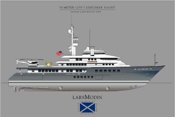

    The Polara Explorer you see here is made with a bow that can take certain ice, but for heavier ice the stabilizers has to be removed in advance. There exist also certain ice eating propellers, screwlike but very few pleasure boats have them or the real Ice classification. Many boats have no classifications at all but are built to class nevertheless. It has mainly to do with the regular controls that has to be made to keep them in class which owners don´t care to pay for or to take the hassle.

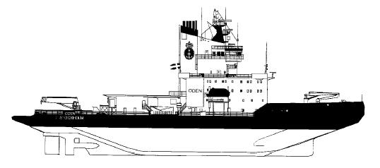

    A real offshore Ice Breaker looks like this Swedish built Oden. The props are protected and they have ballast tanks to change the center of gravity to break ice by moving the bow up and down over the ice.
    They are also used for scientific cruises to the polar areas in the summer. Right now they are near the North Pole together with the American icebreaker Healy.
    Built at Götaverken, Sweden, launched in 1987.
    Length 107.69 m
    Beam 31.2 m
    Draught 7-8.5 m
    24.500 Hp diesels
    Bunker 4.000.000 litres!!
    The steel in the bow is 56 mm, just over two inches thick...
