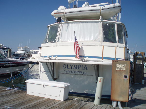

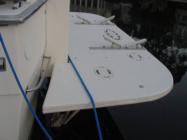

    While cruising the web, I found this cool elevator. It uses original styled platform but it's travel and utility just blew me away. Why climb any ladder at all?
    When we get rich and famous, I'm doing this idea.

    My vote goes to the hydraulic platform, as in your (rcrapps) pics.
