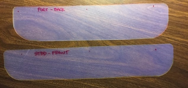

    1. Purchase a small amount of 40 gauge polished Isinglass (example: Ebay $10)
    2. Cutout the Isinglass in the shapes as shown in the picture below. These are plastic templates that I cut after measuring on my boat. They're generally about 3" wide and 13.5" to 15" long, with fronts longer than rears. Depends on your boat so measure first.
    3. Line up the screw holes on the hull and drill Isinglass holes to match. Remove the screws and place the Isinglass behind the stainless steel band and tighten screws. (Easier to do, when boat is out of water, but can be done very carefully in the slip ).
    4). When screws are re-tightened, this will set the Isinglass at a nice outward angle and prevent the water from running down the hull sides. Instead it drips off the Isinglass directly into the water. I get 2-3 seasons on them before renewing with another set.

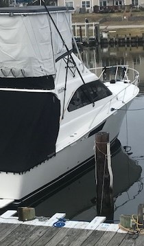

    Here's how they look on the boat (winterized now) - end result, no more dirty line on the hull to clean.

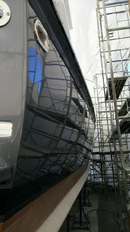

    When I rebuilt my Hatt 53c, I replaced the stainless rub rail throughout. As I installed it, bedded it not place, I drilled and set a length of 1.5" 316SS flat stock (perhaps it was 1.25mm thick in long lengths) between the new rail and the hull so that it extended about 5/16" below the bottom of the stainless rail. This created a permanent drip edge that kept runoff from streaking the hull, and it wasn't unsightly or an ongoing maintenance issue.
  7. rtrafford
    rtrafford Senior Member
    Jul 13, 2019
    1,818
    Vero Beach
    The 316ss flat stock was more or less in a roll, like a very stiff tape. I just rolled it out, cut it to length, stopped it just short of the transom, but it caught the majority of the water that shed from the decks and prevented it from running down the hull. No one ever saw it, noticed it, or commented on it. In fact I'd forgotten about it altogether until I read this thread. Zoom on the photo, taken several years later during a repaint.
