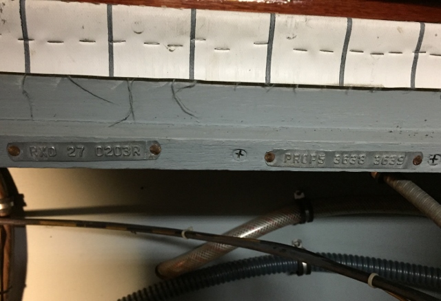

    I found my hull # in the jamb on the lid to the salon companion way hull #.jpg

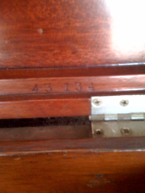

    I also have been looking for the Hull ID No. of our recently purchased 1963 C.C. Roamer (Comet), aluminum hull; evidently the one I was given might not be correct. Anyway, I looked on the the lid or jam, as mention above by "Scully" above, and found this number stamped into the wood G34 205, or what I guessed as this number (the G and the 3 not easily identifiable). What could this be? the number supplied with the insurance information was SR22031 or SR 22051 (both showed up on different documents). The reason I want to know, other than just to want the correct number, is to help find 2 new struts; the existing struts are too old and corroded to identify stamped numbers on them. Thinking I may need to fabricate new ones. Whew!

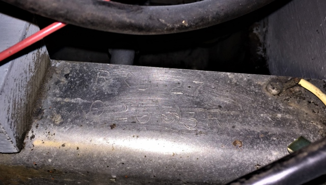

    63ROAMER - Like "Scully", found mine on the starboard engine hatch interior frame on a strip of metal just like he shows in his picture. It should read RXE 27-0XXX. My Comet is a '63 as well, RXE 27-0618. Nice looking Comet!

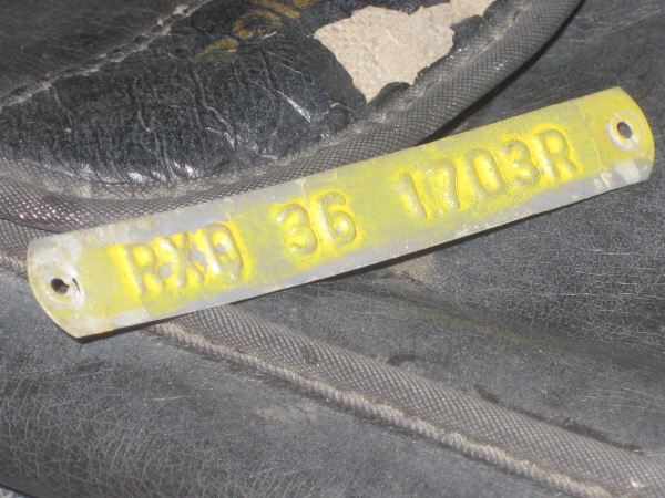

    On my 1963 Silver Comet it is stamped on the port engine stringer at the cabin bulkhead and on tags, forward starboard hatch.
