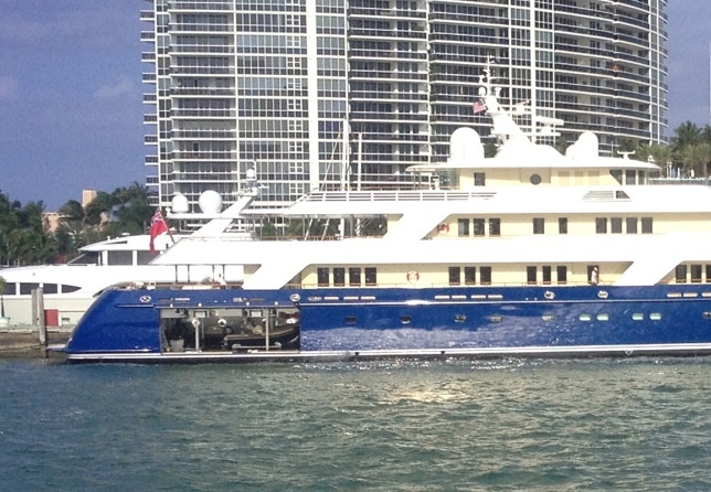

    This obviously much bigger than any boat I ve owned or run so may be it s perfectly fine...
    But leaving such a huge garage door open in an area open to numerous wakes just doesn't seem very safe. This was on the outside of Miami beach marina facing the channel and yesterday that boat was on south side of the port of Miami which is not wake restricted. On both days I saw the door open over a long period of time with no activity seen inside
    Plus the generator exhaust coming out a few feet away? Maybe hard to see on the pic but steam/exhaust could be seen in front of the opening

    It will depend what the arrgt is either side of the opening.
    It might be an isolated area between bulkheads that is designed to be able to handle water in there.
  3. Capt J
    14,653
    If the doors on the other side are water tight, it's ok to leave it open. But, I still wouldn't think it's too wise to leave it open. If a wave rolled in there, it would still batter the toys......

    I'd guess it's a non-issue. Or the captain, and or engineer, would not allow it to be open when the toys are not being launched or retrieved.

    Not exactly sure where that hotel/condo is located in relation to any traffic that may produce any large wakes (perhaps Pascal could enlighten me). But I bet it would take a large wake to cause any flooding to be concerned with. So again I'm whiling to guess it's a non-issue where is as is.

    I m sure it s really a non issue but seeing that big hole about a couple of feet above WL had me wonder
    It was indeed MIami beach marina although the day before they were tied to the south side of dodge island, door open, in a fairly high wake area. Even there on the outside of MBM there are a few idiots that will push a good wake.

    It is okay
    Many large yachts have similar arrangements.
    The sections forward and aft will have self closing watertight access doors on an interlock with the hull opening doors.
    It will be impossible to open the hull door(s) with the any of the watertight access doors at each end open.
    Crew will be able to move in and out of the area through the watertight access doors but they will close automatically behind them.
    The space below will also be watertight.
    So in effect the open area is just a platform
    These installations and their operation have to be approved by the classification societies.
