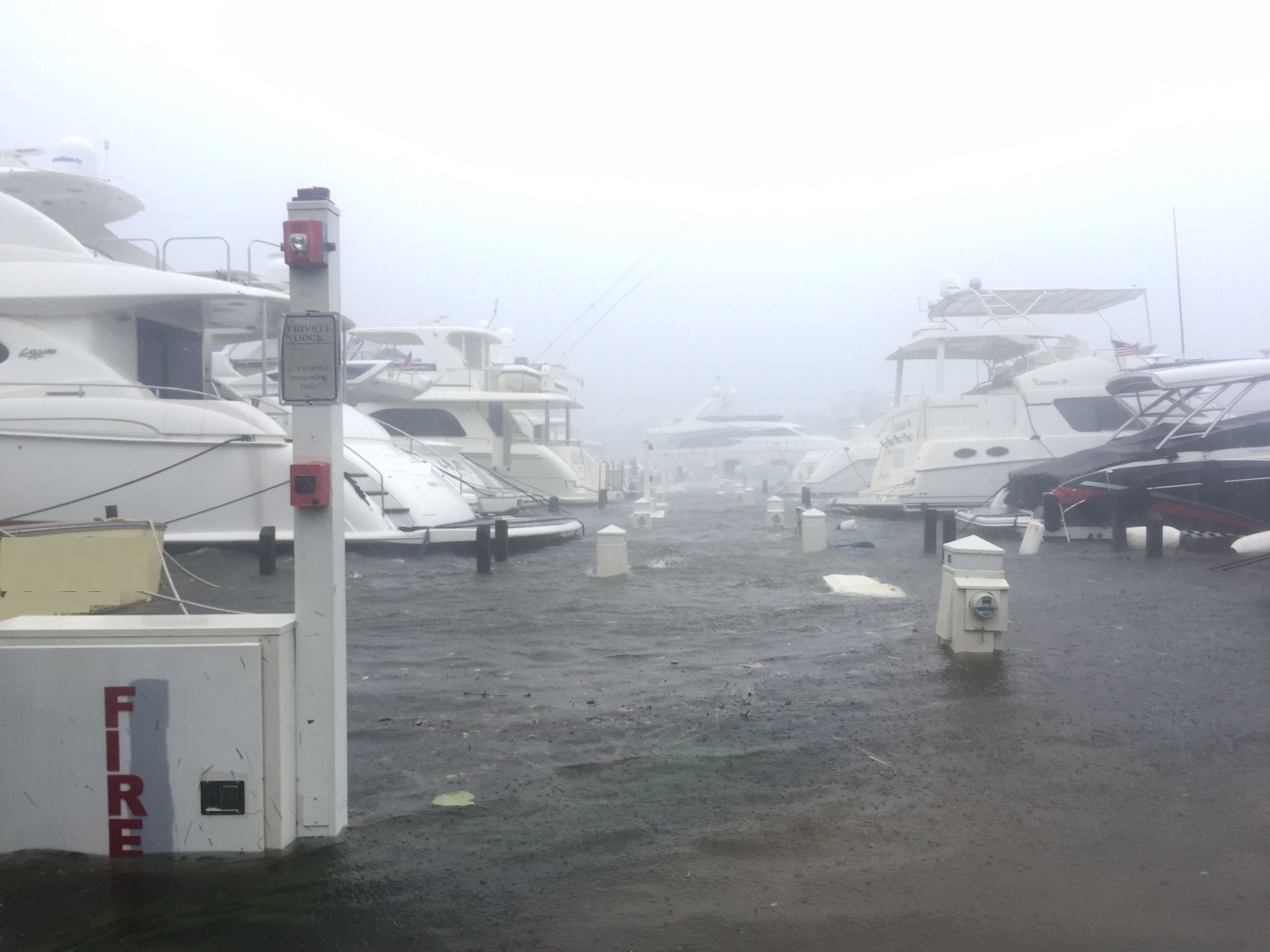

  7. CPT2012
    CPT2012 Member
    Jul 11, 2013
    37
    MIAMI FL
  8. Capt Ralph
    12,727
    Woah, Heck of a way to wash bird poop off of the docks.
